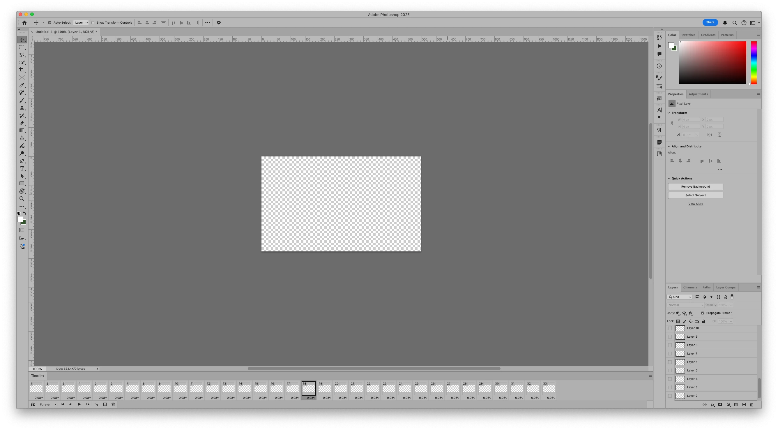

P: PS v26.1 "Import video to layers" not usable any more with ProRes (4444, 422)
The "import video to layers" features is unusable after the latest update.
Since I use this feature all the time this is critical for me!
- i am using a .mov file that has worked before (prores 4444, 10mb, 3seconds)
- clicking ok makes the dialog hang 30 seconds with spinning beach ball
- "Making layers" process takes 7 minutes! It took 7 seconds before!
- the opened layers are all empty
Macbook Pro M3 Pro, macOS 15.1.1
Photoshop 26.1.0 20241113.r.121

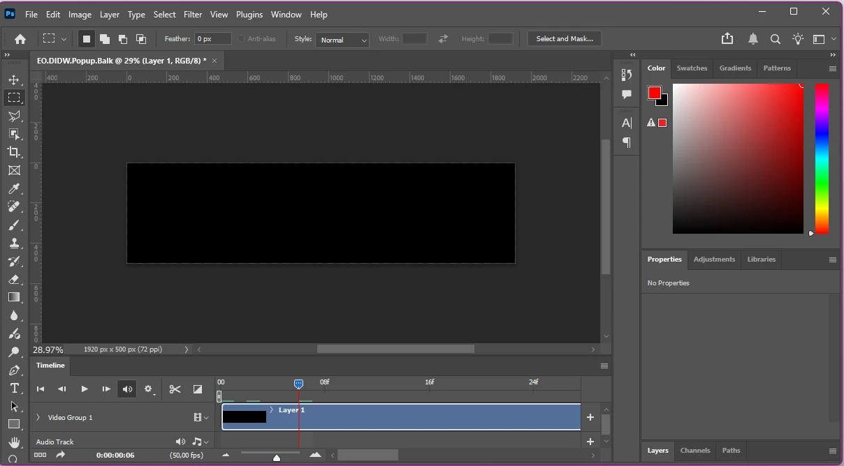

April 14, 2026
ProRes 422HQ and 4444/4444+ won’t playback, only show black, and cause extreme slowdown/lag in Photoshop 2025, and Photoshop 2026. Works great in Photoshop2024.
System Configuration (7970X - BROKEN):
  • AMD Threadripper 7970X (32-core)
  • Dual NVIDIA RTX 4090 GPUs
  • Windows 11 Enterprise, Version 24H2 (Build 26100)
  • HVCI/Memory Integrity: ENABLED (CredentialGuard, HypervisorEnforcedCodeIntegrity running)
  • ASRock TRX50 WS motherboard, BIOS 14.10
System Configuration (3970X - WORKING):
  • AMD Threadripper 3970X (32-core)
  • Single NVIDIA RTX 4090 GPU
  • HVCI/Memory Integrity: DISABLED
  • Same NVIDIA drivers on both systems
Behavior:
  • ProRes 4444+ and ProRes 422HQ files: Black frames in PS 2025 & 2026 on 7970X
  • Same files work perfectly in PS 2024 on 7970X
  • Same files work perfectly in PS 2025 & 2026 on 3970X (no HVCI)
  • Same files work perfectly in Adobe Media Encoder on 7970X (with HVCI)
  • MP4 files work fine in all versions on both systems
  • Performance extremely sluggish when ProRes file is open in PS 2025/2026
