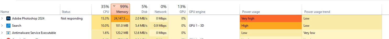

I don't know if it's a normal behavior, but when I use the new "Remove Tool", my memory usage is going crazy : In the task manager it takes 20Go of RAM, and it takes 18Go more on my scratchdisk.
Even if I do teeny strokes on an white layer.

PC windows 11 pro , i9-13900KF , 64gb ram , NVIDIA RTX4080.  I had no choice to uninstall v25.2 and install v25 because of that behavior to eat way more RAM, at a point to freeze PS and a message saying not enough ram !!!! first time I experience that with ADOBE.....

@Kevin Stohlmeyer
Huge thanks for your answers and for being proactive; I appreciate it.
The behaviour that you described is exactly what happens to me, although mine goes up to 25 gigabytes, as you can see, and freezes my entire Photoshop. The memory then goes nuts, moving quickly from 25 to 17 back and forth until it stays at high numbers, and I have to kill the app.
