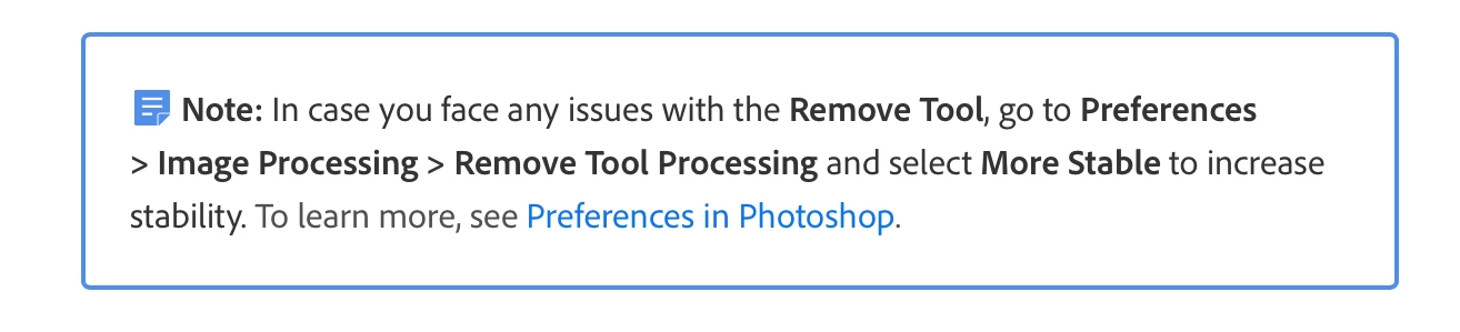

4. Does it still occur if Preferences > Image Processing > Remove Tool Processing =  More Stable?
   ( I see that does not solve the issue for @Dawn26748925htc0 )

I'm having the same issue with the remove tool. It seems to work correctly sometimes, other times it leaves a brown smudge. (Yesterday it worked well about 80% of the time; today it's worked about 20% of the time). I've tried reinstalling PSCC 26.4 and have also gone into Preferences to make the Image Processing "More Stable" per the suggestion, but it continues to function inconsistently.

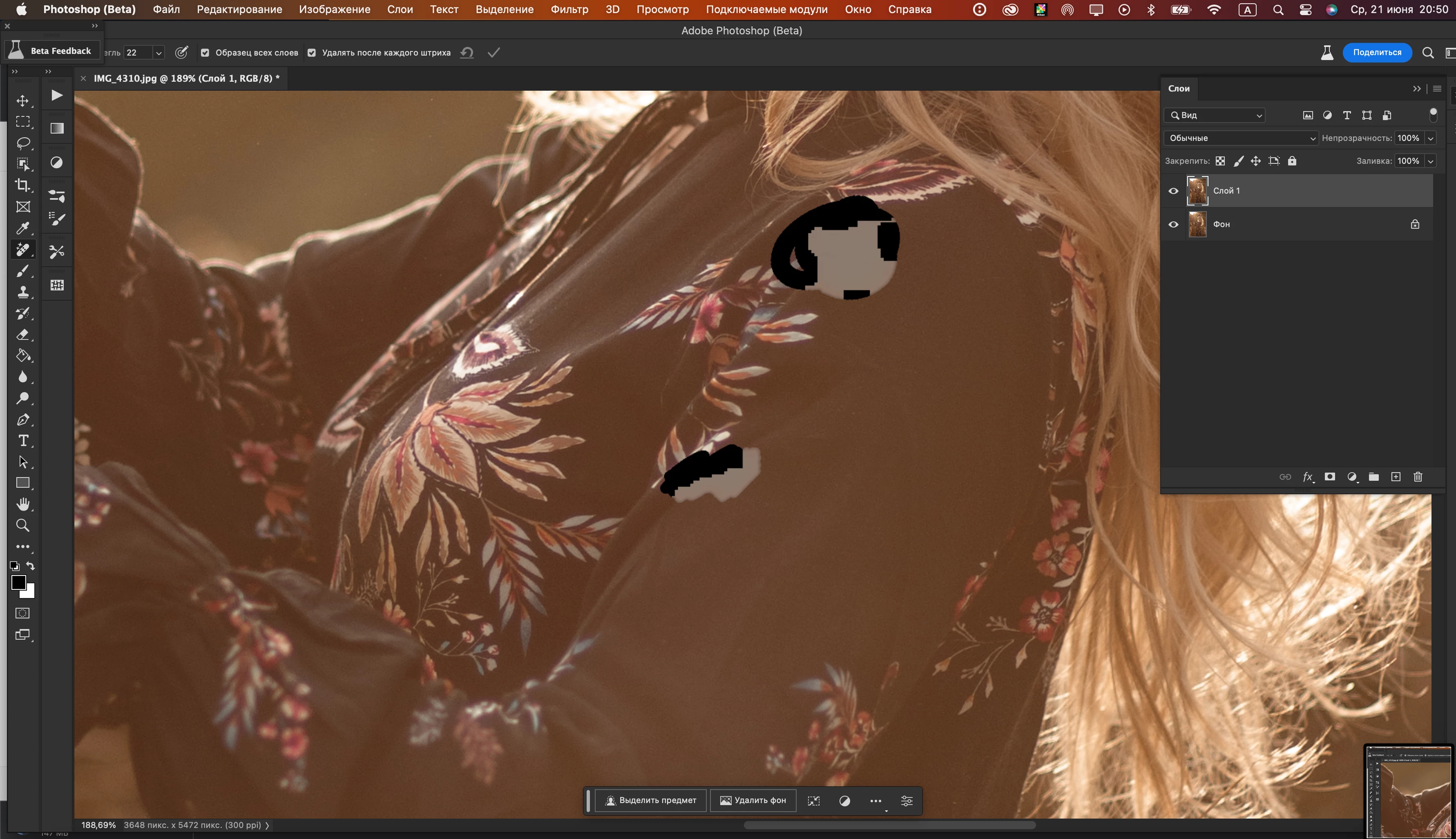

Jun 21, 2023 2:59 PM UTC
Remove tool not working in Beta
Leaves only gray spots
CShubert
Jun 21, 2023 3:10 PM UTC
Hi @Colibrisphotography
Try resetting Prefs for the Beta:
/Users/yourname/Library/Preferences/ Photoshop Beta Settings (Mac Ventura)
/Users/yourname/Library/Preferences/Adobe\ Photoshop\ \(Beta\)\ Settings (Mac)
C:\Users\user name\AppData\Roaming\Adobe\Adobe Photoshop (Beta)\Adobe Photoshop (Beta) Settings )Win)
Launch BETA Photoshop While Pressing The Keyboard Shortcut
With Photoshop closed, press and hold Shift+Ctrl+Alt (Win) / Shift+Command+Option (Mac) on your keyboard and then Launch Photoshop the way you normally would.
https://helpx.adobe.com/photoshop/using/preferences.html#Manually 
It may help if we could see your Photoshop System Info. Launch Photoshop, and select Help >System Info...and copy/paste the text in a reply.

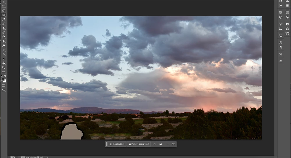

urbanlights1
Jun 14, 2023 10:24 AM UTC
remove tool is not working , just leaves a mess
