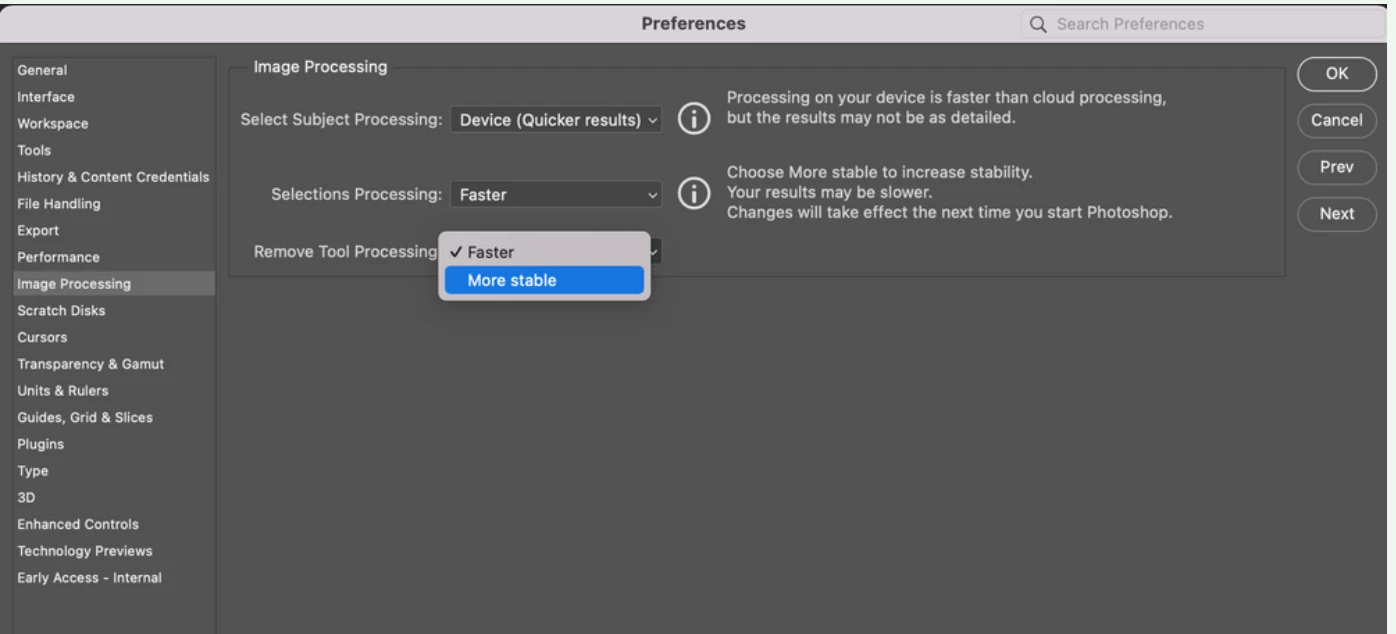

Marcella87
Sep 15, 2023 4:55 PM UTC
To go to the Preferences and Choose "Stable" for Processing Removal tool HELPS!
I had to make a newstart of my computer bevore it works... but it works!
Thank You
