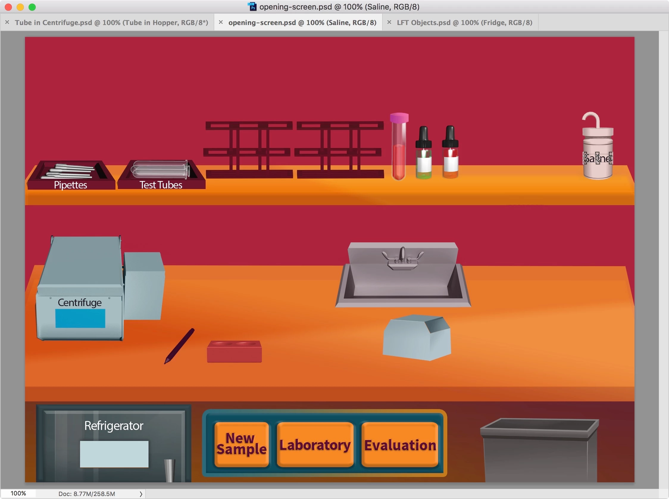

Are you Mac or Windows? Are you document windows docked or floating? A screen shot of before and after would also be helpful.
dr_melzieAuthor
Jun 20, 2017 6:41 PM UTC
Before and after I click on a tab.
