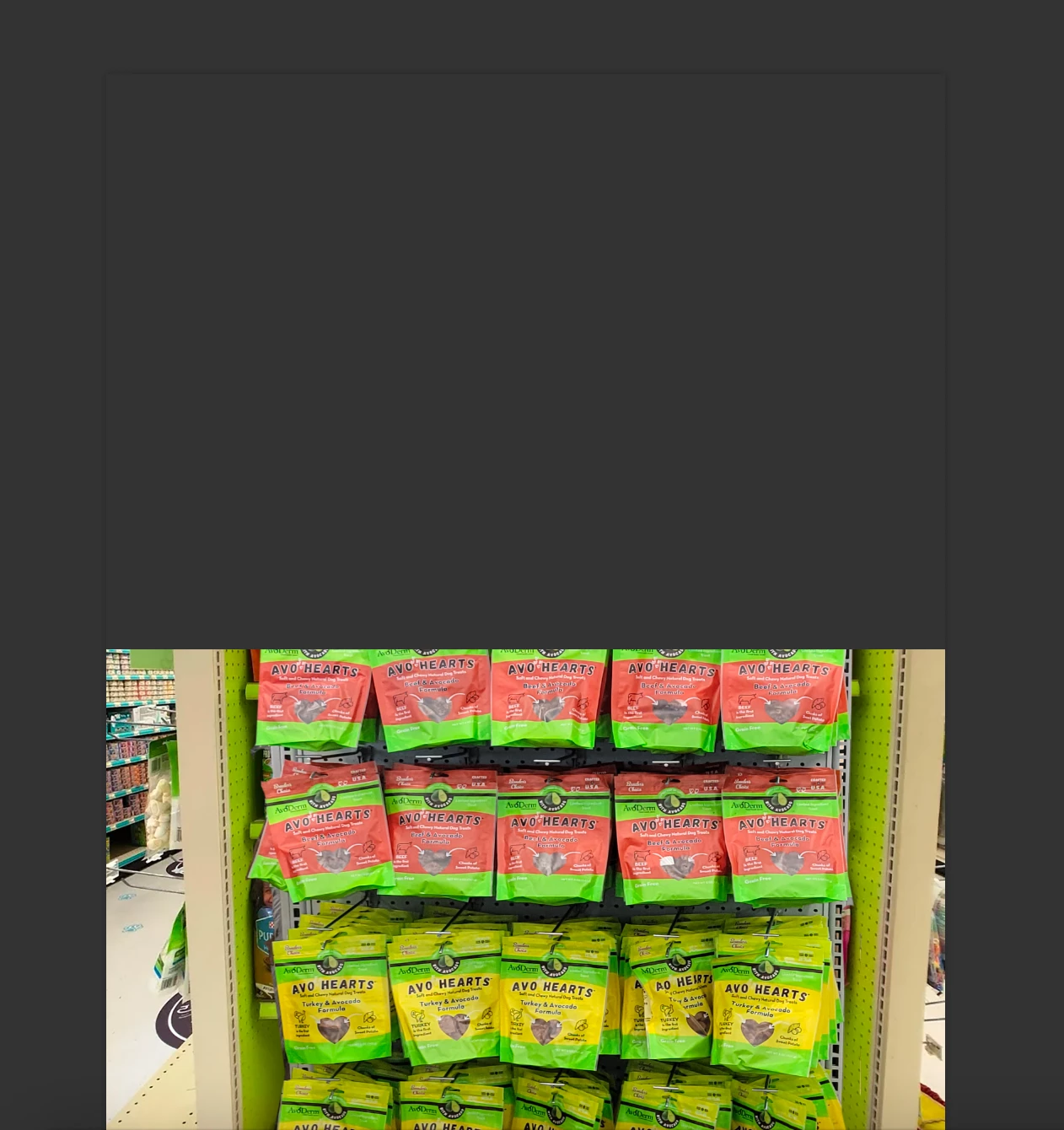

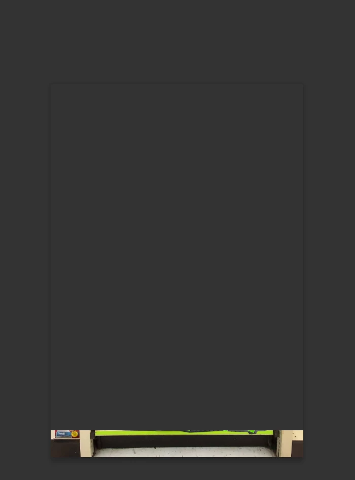

P: Zooming in and out in full screen mode
Zooming in and out in full screen mode gone a bit mad, see attached video, does the same thing with either ctrl - and + or the mouse scroll wheel, Photoshop version 23.5 on Windows 10

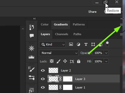

@CShubert Enable Flick Panning was already unckecked, tried unchecking Animated Zoom also and no change, another thing I noticed, when you hit the escape key to come out of full screen mode and hit ctrl + k, Photoshop acts as if I hit the minimise option as you can see, I have to hit the restore option to maximise the window again
