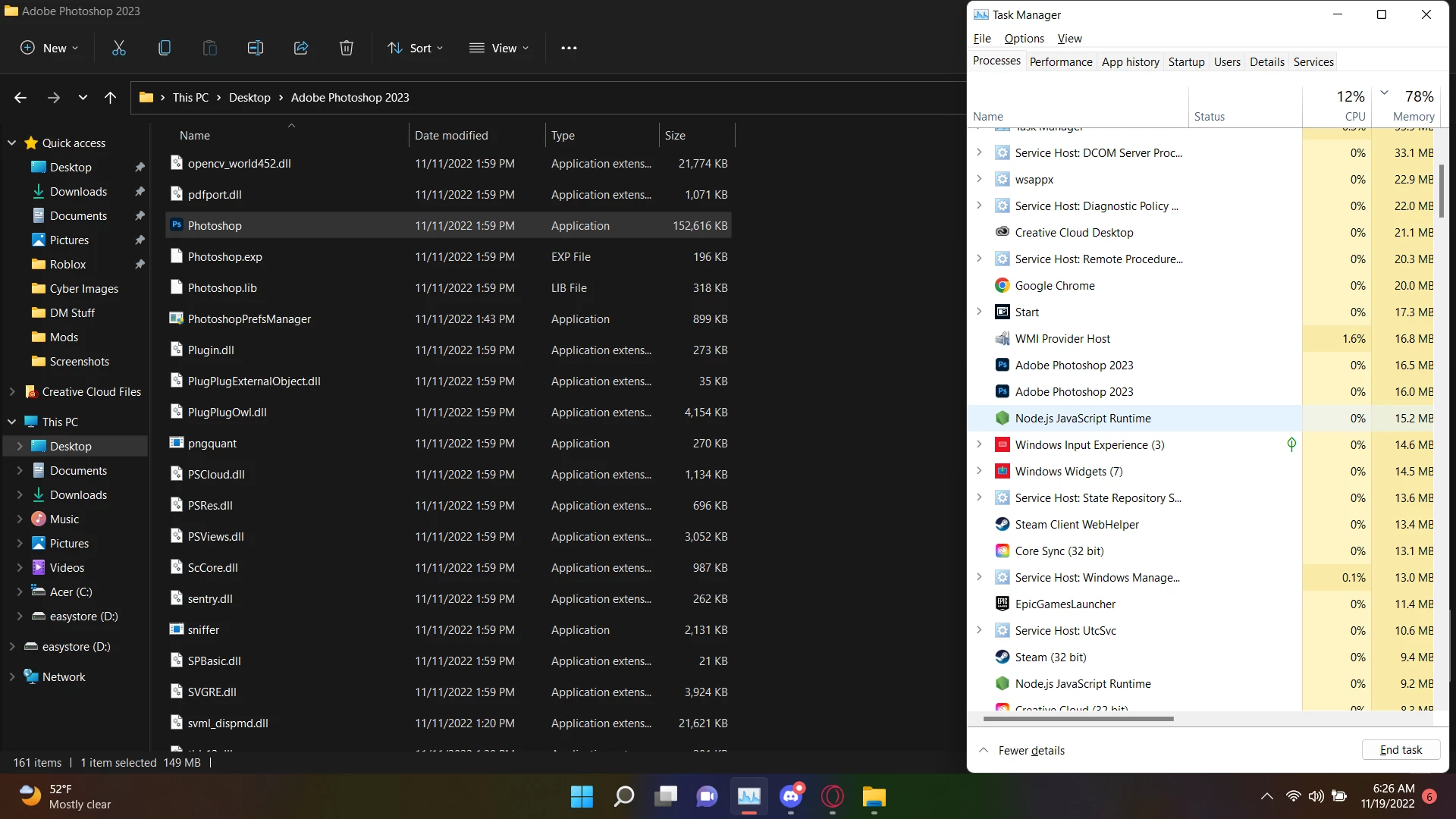

I can open Photoshop, it appears in task manager, however it never actually shows up. I have tried every single method to my knowledge and found nothing that works. Quite literally every single other Adobe CC program works but just not photoshop. I have the latest version of photoshop aswell.
Methods Ive Tried:
- Uninstall and Reinstall Photoshop
- Run it as administartor
- Run it from task manager
- End task then run it
- Run it from Adobe CC
- Update it to the latest version
- Turn off and on my PC and try all these things again
Essentially what it does is just run in the background and never actually opens the startup. I have the exact same specs I did before but it is just now not working.
I have a ACER Nitro 5 Gaming Laptop with Windows 11.
So PLEASE I need help with this, I need to get my commissions done.
Heres whats happening, I run it and it just runs in the background.

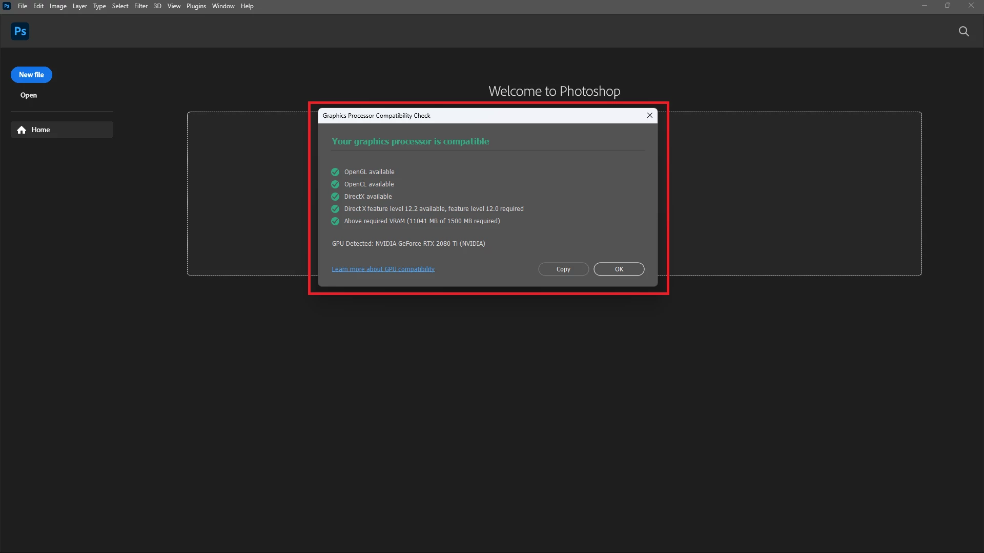

I had the same problem and it fixed somehow
this is the methods I tried:
1- Updated my graphic driver to the latest version
2- Installed Intel CPU driver
3- Checked If OpenCL and OpenGL is installed
4- Installed Open Gl Extensions Viewr 6.1
5- Installed DirectX 12 (first check if your graphic card supports directX 12)
6- Checked if my VRAM is enough for photoshop
I also restarded my computer after I did this methodes and run photoshop as administrator
I hope this solve your problem and have a good day❤️

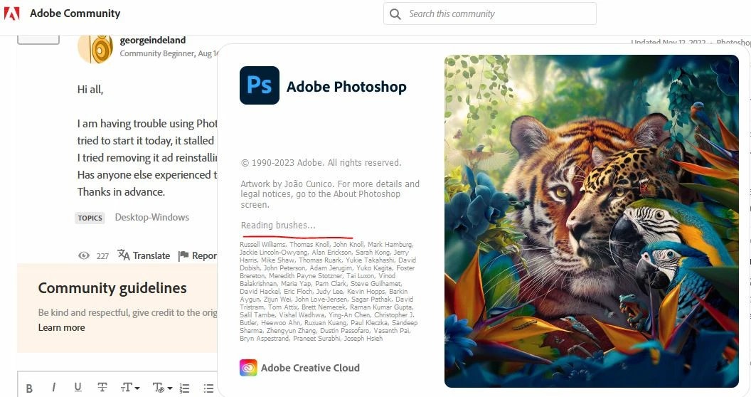

I can't launch Adobe Photoshop after updating, it gets stuck at Open screen.
reading brushed
I am having trouble using Photoshop Beta.  I have been using it for a long while without any problem, but when I tried to start it today, it stalled at the "Reading Brushes" and exited due to an error.
I tried removing it ad reinstalling and rebooting my machine, but all to no avail.
Has anyone else experienced this, and/or know a solution?
Thanks in advance.

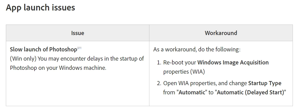

ocelot77
November 29, 2023
UPDATE: So it seems it does eventually start...after several minutes. And I can't seem to find WIA running on my machine, so...what now? This is ridiculous, Adobe!
