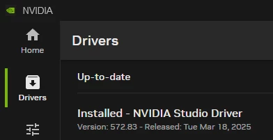

@jamieclarke
The latest Studio driver 572.83.
jamieclarke
Apr 11, 2025 12:31 PM UTC
Hi @aspenn - Can you confirm which GPU driver version you are using and whether it is the Game or Studio driver.

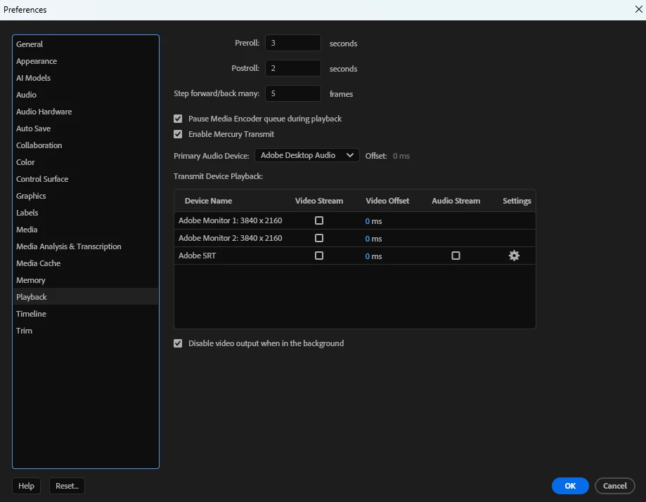

@jamieclarke
Playback settings don't have anything related to AJA or Blackmagic:
Also, the system search didn't return anything that would imply those drivers would be installed (I have never installed them and I've been the only user of this system).
