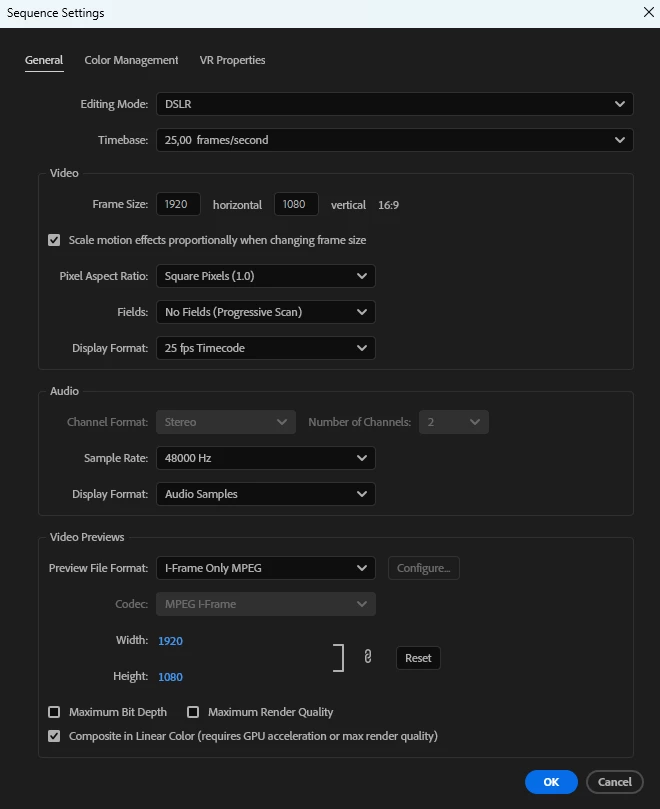

@jamieclarkeMy sequence settings:

Hi @aspenn - Can you post a screenshot of your sequence settings.  Since you are rendering your sequence there are video preview files being used,  It's best to have these set to ProRes Proxy.  Can you answer the questions in the pinned post.  HEVC 10bit 422 files are not hardware accelerated unless you are using an Intel 11-14th gen with an iGPU and Quicksync enabled.
