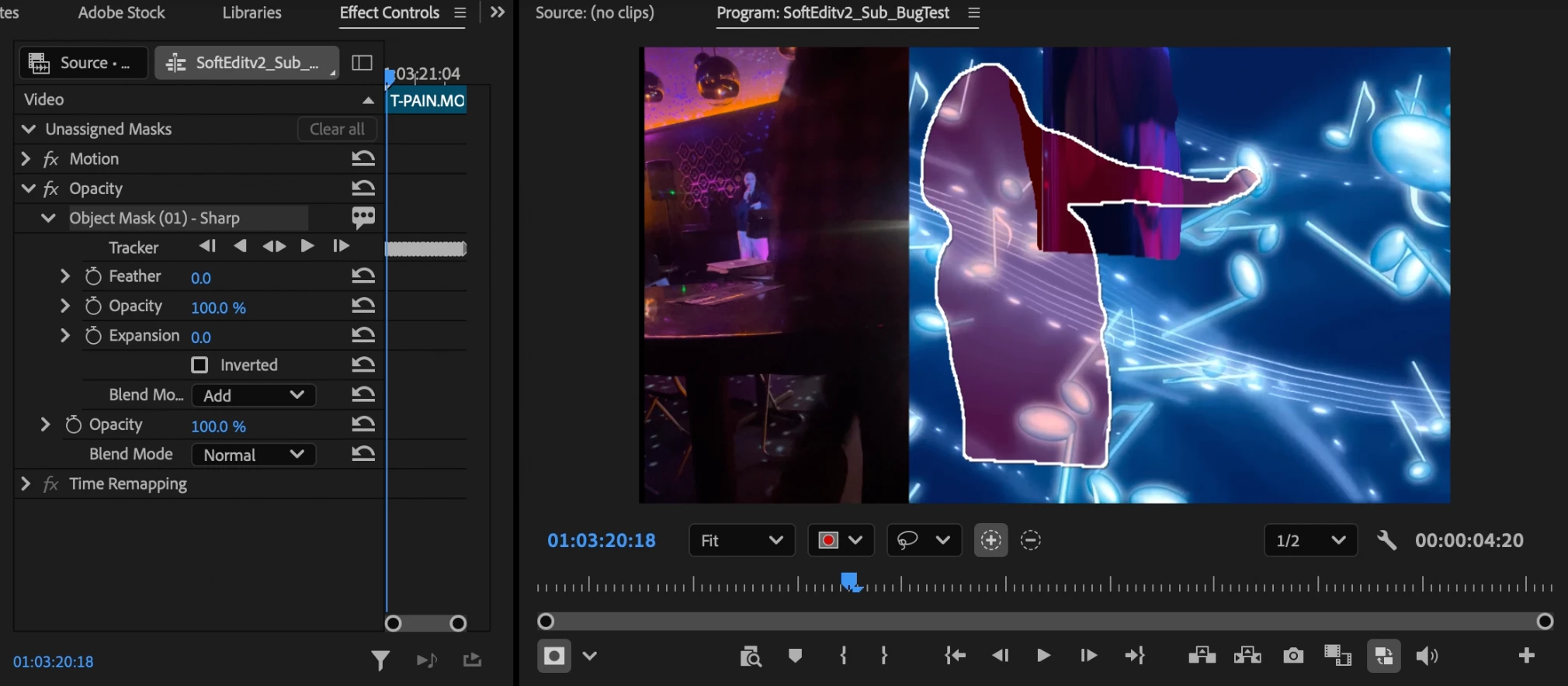

    In my experiments we do have an issue with Variable Bit Rate (VBR) footage glitching when the resolution is set to ½ that we are currently working on. Could you do a screen recording where the Object Mask is selected so we could possibly see if the outline of the mask is still working, it just can’t capture the original frame because it bounced up out of visible frame?
    My experiment - Object Mask is still where original is supposed to be. Original footage (VBR) is bounced up and squeezed. My Object Mask was tracking something vertically low, near the bottom of the frame so I can still see it onscreen.
