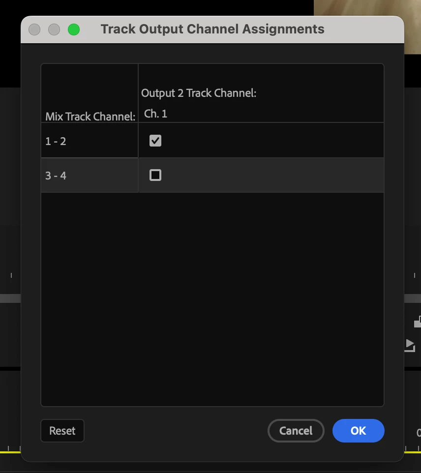

My suspicion here is that the audio track your new sequence has is a mono track and your audio is only on one side. Or you have an audio interface and it is routing the audio out outputs 3-4 not 1-2.
I think the default sequence presets have changed or been updated in 2025 so that when you create a new sequence, it loads with audio channel presets also.
For ezxample, if i go to create a new squence it loads with a 23.98p timeline with 4 mono tracks by default. So when you put a stereo track on it, it will only play out one side of the speakers/headphones.
You cannot unfortunately change a mono track to a stereo one so you just have to create a new one and drag the audio onto that.
To confirm this is your issue, on the audio track, right click on where it says Output 1 or Output 2 and go to Track Output Channel Assignments.
If it only shows Ch1 or L or R, then it is only a mono track.
