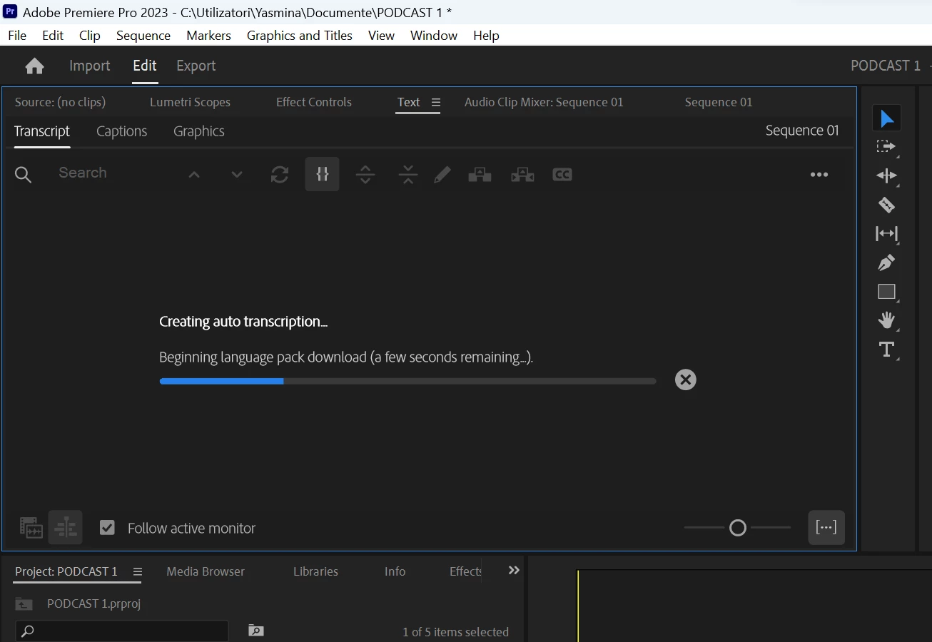

IASMINA38750930b7vc
Jul 23, 2024 10:47 AM UTC
Yes @Stan Jones  you are right. Beginning language pack download.
My connection is 65  Mbps at the moment. And it's the first time when I am doing transcription on this laptop ...
So it can take longer than 2 hours you think?
THANKS!
Stan Jones
Jul 22, 2024 9:56 PM UTC
@IASMINA38750930b7vc,
Did the message change from "downloading language pack"? That can take quite a while, particularly if you have a slow connection.
Stan
IASMINA38750930b7vc
Jul 22, 2024 8:06 PM UTC
Hi @Kerstin Ebert
Any thoughts please on my bug today?
I left the caption-transcribe to do its magic for like 2 hours, but still it did not move ... it keeps loading, even if I chose just 3 min. of video.
Or is telling me that there is no dialog in my videos but it is, I have a podcast in there ..
Looking forward to your feedback.
Many thanks!
Iasmina

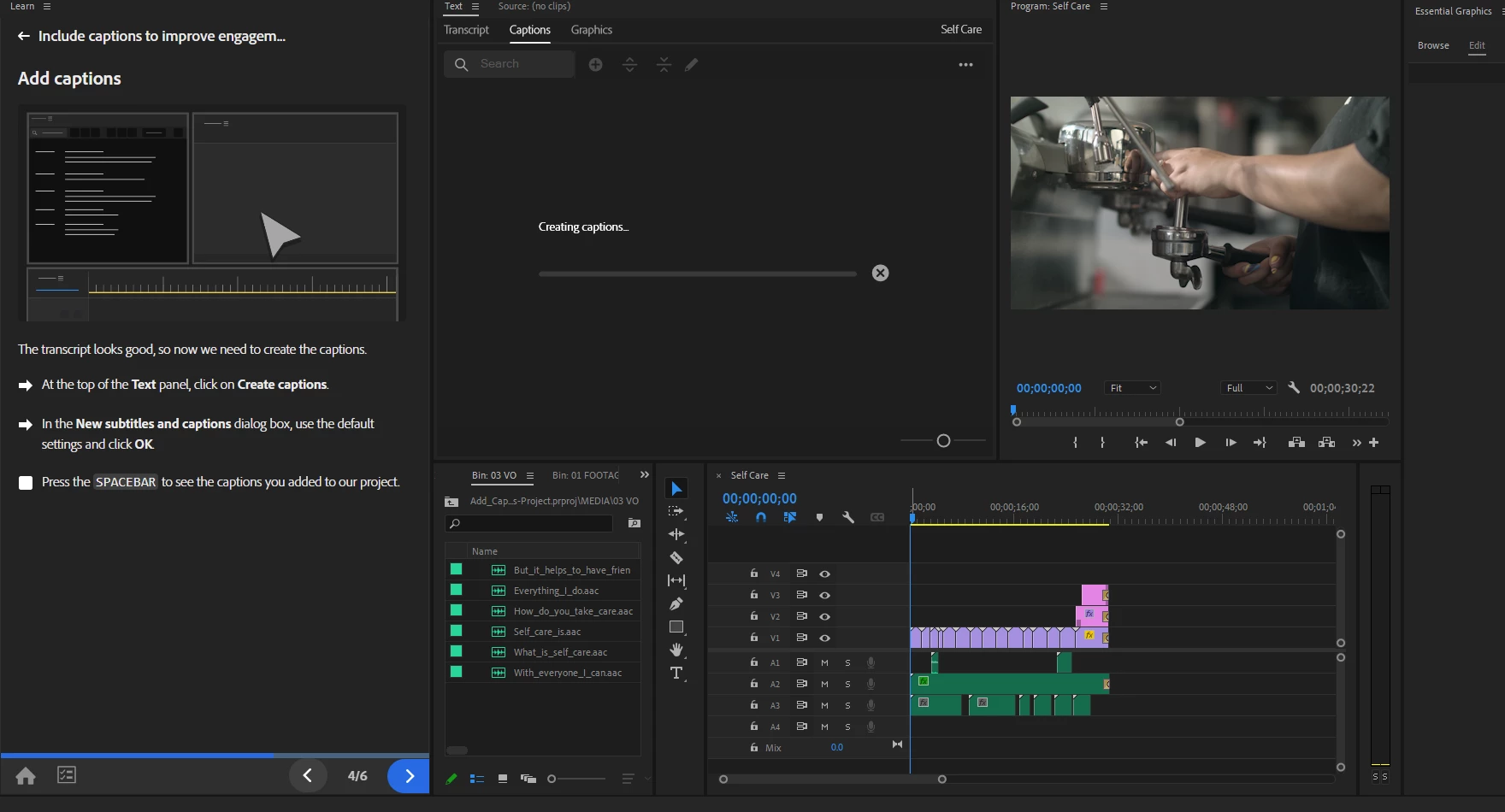

Apr 10, 2024 1:11 AM UTC
I just got Adobe Premiere pro, so I am on the latest version, v24.3 and I have this issue in the tutorial that teaches you how to make caption, part of the social media video tutorial. This is not a good look for Adobe, I have attached a screenshot. Maybe trying the tutorial might help you replicate the bug and solve this issue. The fact is that it stuck on creating captions for 5-6 words at best, is actually quite poor. I am running window 10, latest version.
