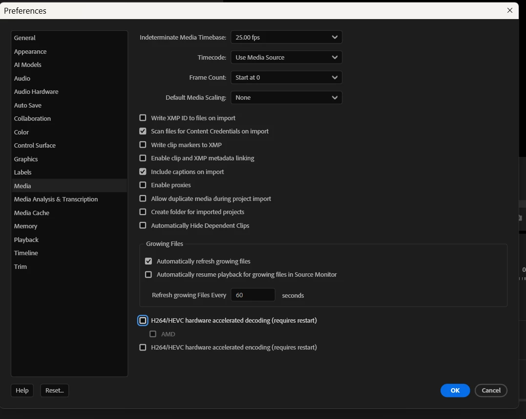

I can see how the frames and previews are repeating. Did this only start happening with this specific batch of videos? Wondering if this is file specific. If you excluded the one file that is being repeated into the other videos from the queue in Media Encoder, are the rest of the files affected as well? Under Settings/Preferences > Media, does this happen if you also disable ‘Enable hardware accelerated decoding’ in ME as well?

  • I went to the Media setting in Preference and noted that 'Enable Hardware Accelerated Decoding' was showing two options (AMD) See attached Screenshot , I have deslected both and will see how that goes.
