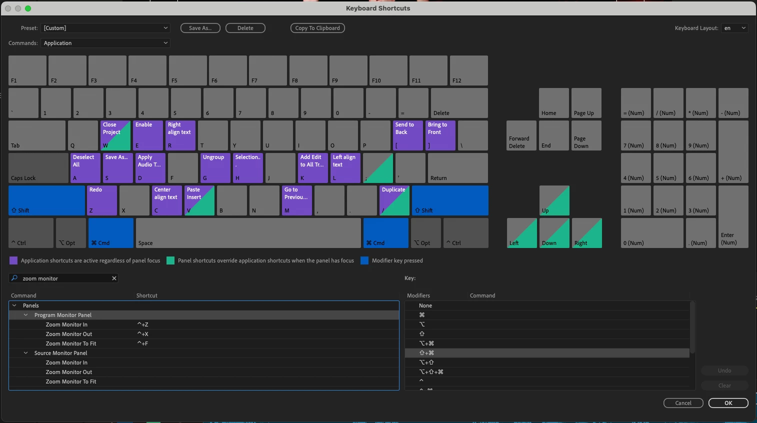

I'm working on Premiere Pro 24.4.1 on a Mac.  I created shortcuts (or at least I tried) to be able to zoom in on the Program Monitor.  Control+Z to zoom in, Control+X to zoom out, and Control+F to fit.   They are listed.  They are visable.  Control+F works, but the zoom and and zoom out do not.
Any ideas what I could be doing wrong?

You can see below that I have Zoom In/Out set to "- / =" with Ctrl modifier.
Can confirm, all other modifiers work when mapped to Zoom In/Out except Ctrl.

I am on Beta 25.1.0 Build 7 and they are indeed fixed. The behavior matches what I described for the magnification level specific shortcuts: zoom monitor in/out zooms on the screen when the shortcut is entered, not the original screen center.
As previously, "Fit" can be assigned at the application level and appears to work correctly. Zoom monitor in/out must be assigned for the Source and Program monitors separately.
Zoom monitor in/out step through the levels of the monitor zoom levels/magnification.

One of the earliest comments in the Beta discussion on the new zoom behavior was that these shortcuts were broken (3/25/24).
They are a little unusual because I do not see any menu, or other, way to access these commands.
The workaround is to use the zoom function. Note that, by default, the scroll zoom uses the mouse cursor position on screen to zoom in/out. Holding alt/opt and scroll uses the screen center (at that point in time - not the original frame center).
On Windows, if you use the Alt, when you release it, it shifts focus to the menu bar, and you must press alt again to return focus to the Program Monitor.
Holding Shift moves in larger increments so you can scroll faster.
As already noted, there are application-wide, program monitor, and source monitor shortcuts for "fit," that are unassigned by default.
There are unassigned shortcuts for Magnification (all the levels of the drop down in the monitors). These zoom in on the center of the screen when invoked, and not the zoom target point nor the original full-frame center. This is different from the behavior in PR 2023 - there, the magnification is always to the center of the original frame. And in PR 2023, where the zoom in/out shortcuts still work, I see that they also zoom to the center of the original frame. So fixing these may also involve changing this behavior. And I think zooming to the current screen frame, and not the original full frame, is better.
