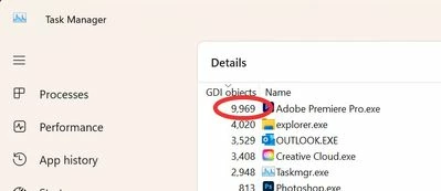

The issue was eventually identified as a GDI object leak that triggered every time I switched between sequence tabs. This was diagnosed by monitoring the 'GDI objects' column in Task Manager under the Details tab (you may need to right-click the header bar and add the column). When the GDI object count exceeds 10,000, Windows stops allocating new objects, causing the UI to become unresponsive.
By keeping an eye on the GDI figure while editing, I was able to figure out the interaction causing the number to spike. I was advised to try the v25.2 Beta, which seems to have resolved the issue (based on a quick test while monitoring the GDI objects count), athough I haven’t done extended testing. For now, I'm working in v24.6.3 while I wait for a stable release of v25.

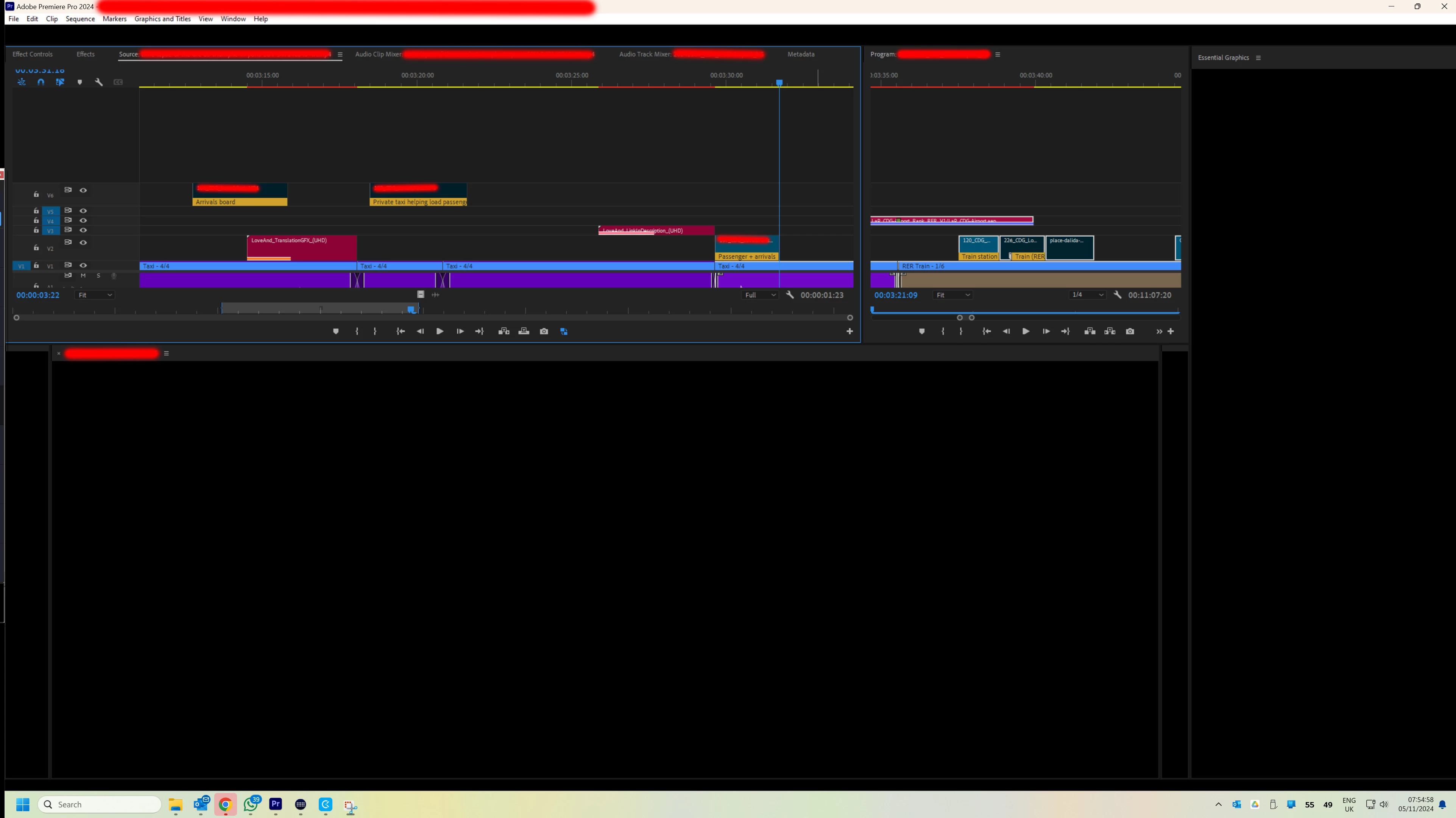

Nov 5, 2024 9:43 PM UTC
Sadly, uninstalling those two plugins hasn't helped.  I've just had another error.
At least this time the resulting Adobe UI x Glitch art was more interesting....

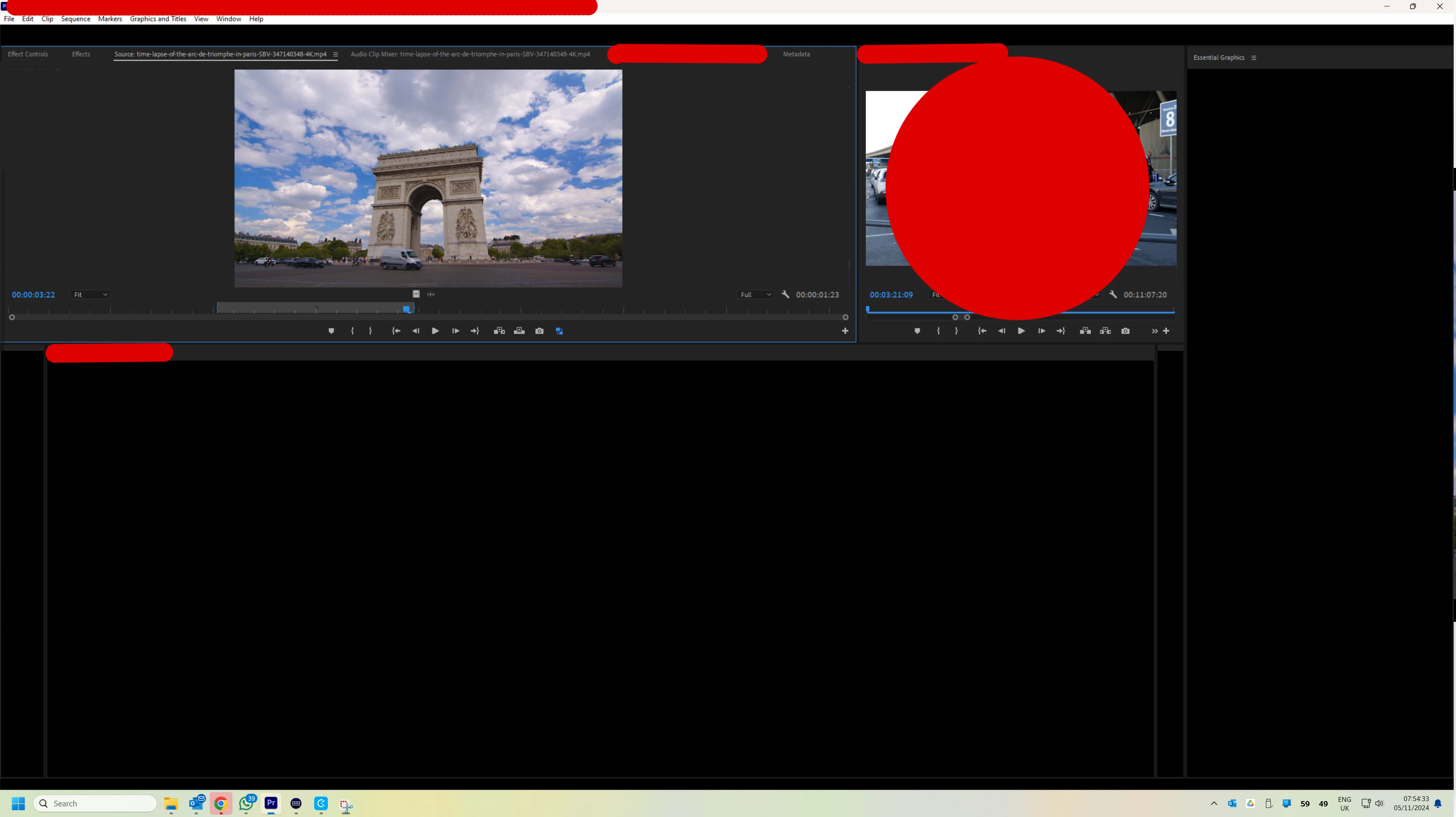

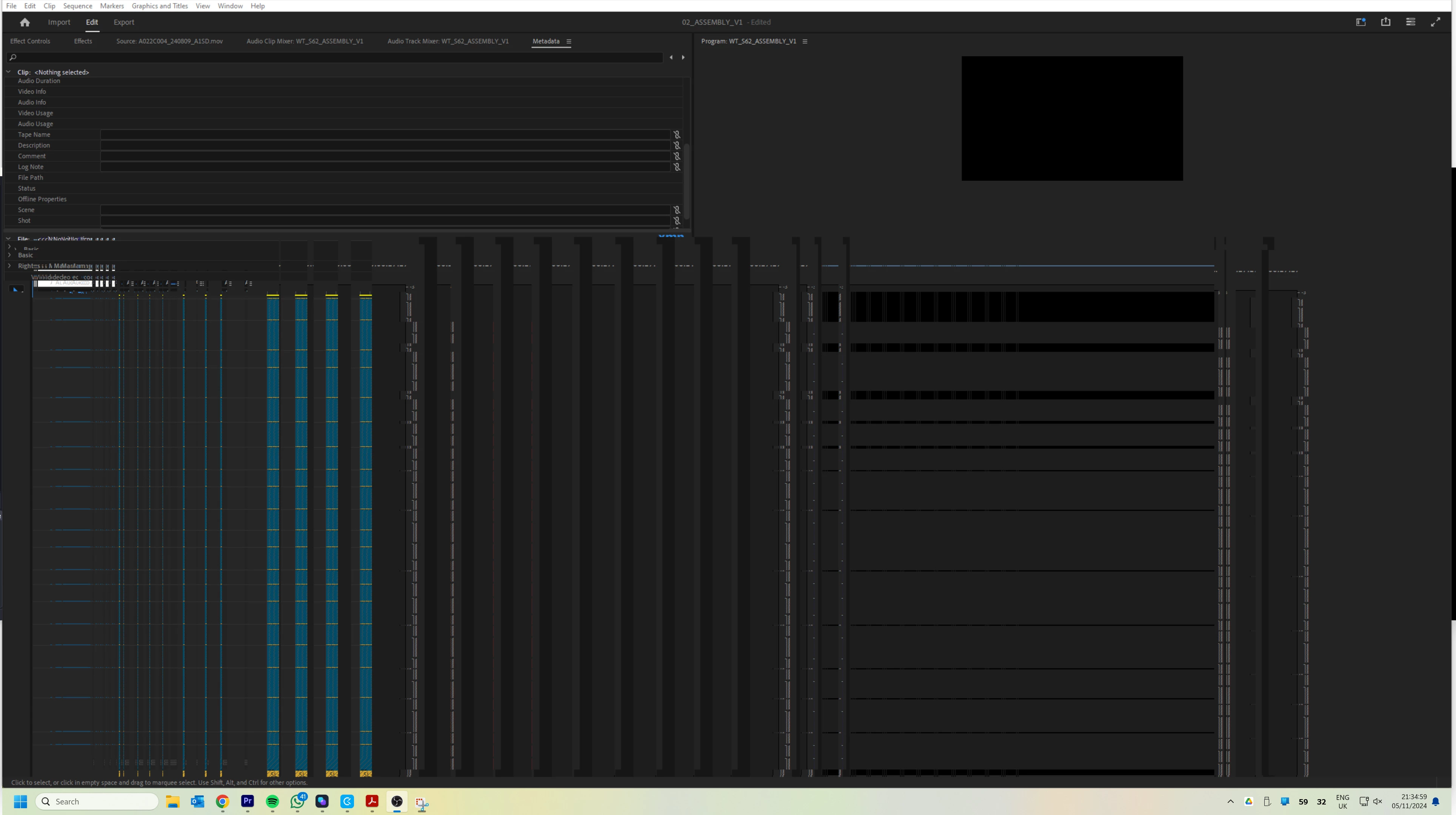

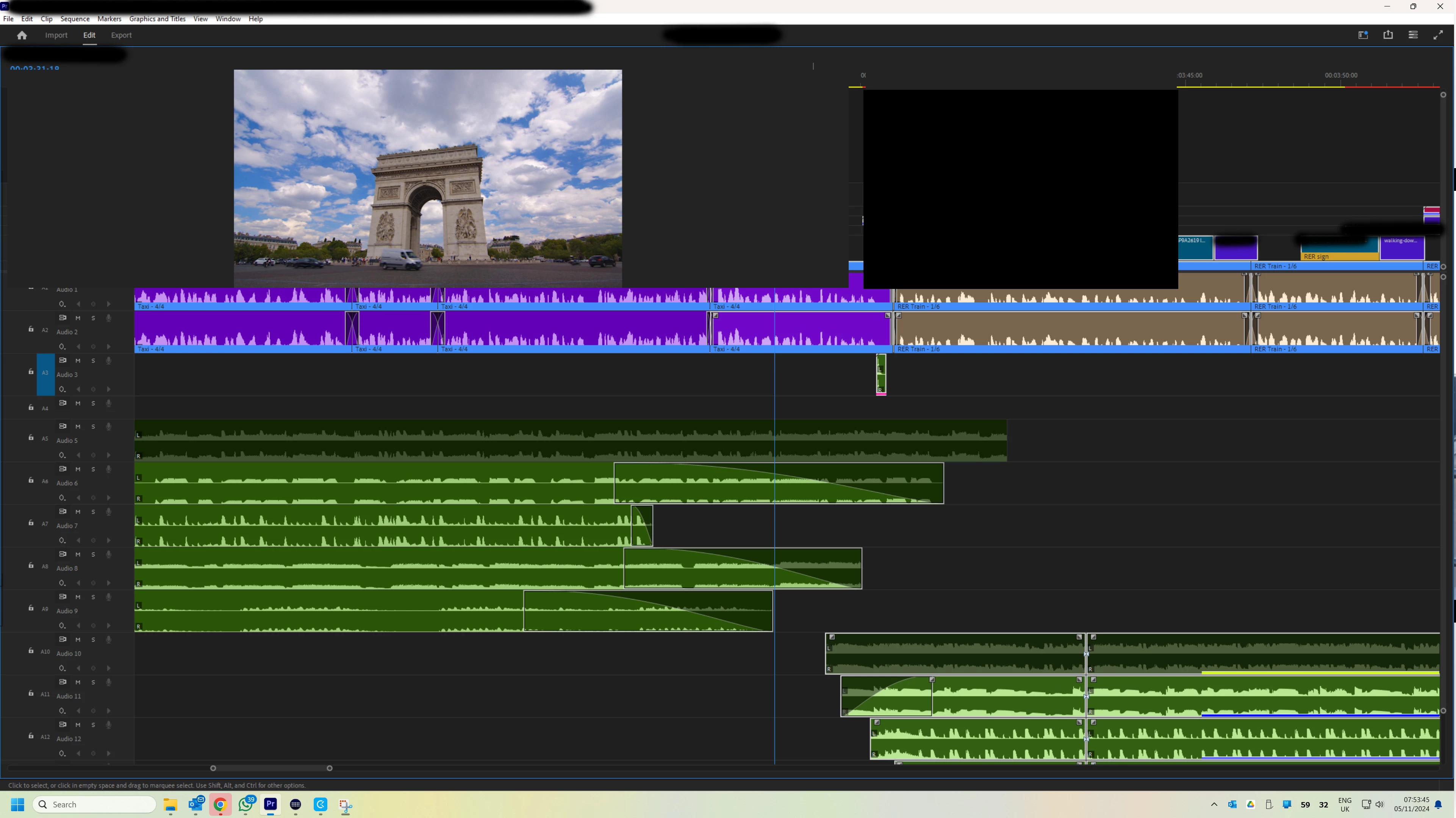

Premiere doesn't typically quit itself.  The UI glitches and the program becomes fully unusable.  But most of the time, I have to force quit myself.
I've attached some screenshots of some crashes from today.  Not the most impressive examples (they can get much crazier!), but they hopefully give a rough idea of what I'm seeing (obviously the lines covering things like file name aren't part of the glitch).
