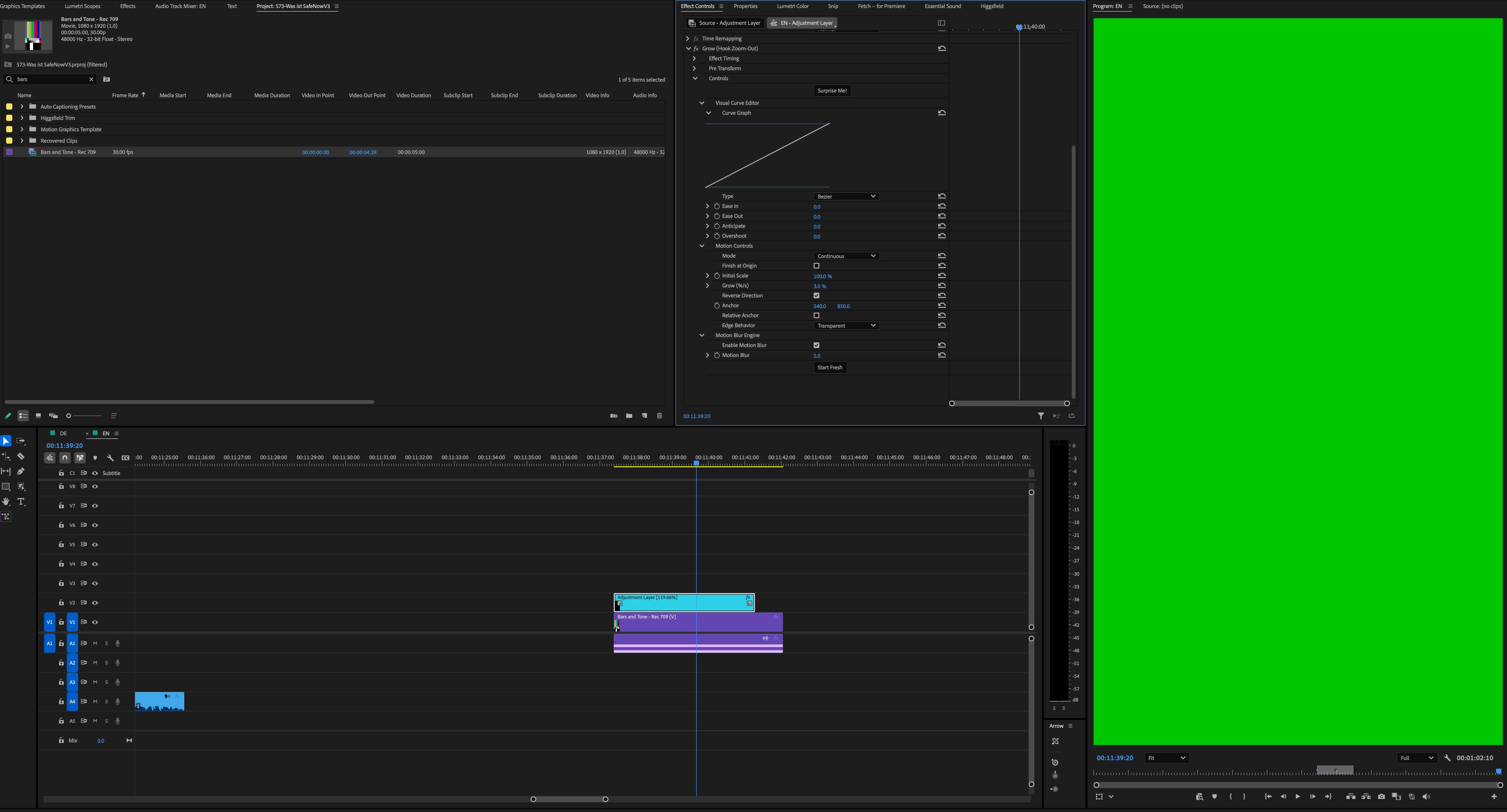

When applying the “grow” effect to an adjustment layer that has beed sped up or slowed down, it doesn't work anymore and just zooms in a lot. Does not seem to apply to video layers. Also some of the other “clip length based” effects like “spin” act weird on adjustment layers that have been changed in speed.
Steps to reproduce:
- Add an adjustment layer to a sequence
​​​​​​​- speed it up using the rate stretch tool
​​​​​​​- apply the grow effect to the adjustment layer
MacBook Pro M2 Pro,
macOS Tahoe 26.2
Premiere 26.3.0 (Build 93)

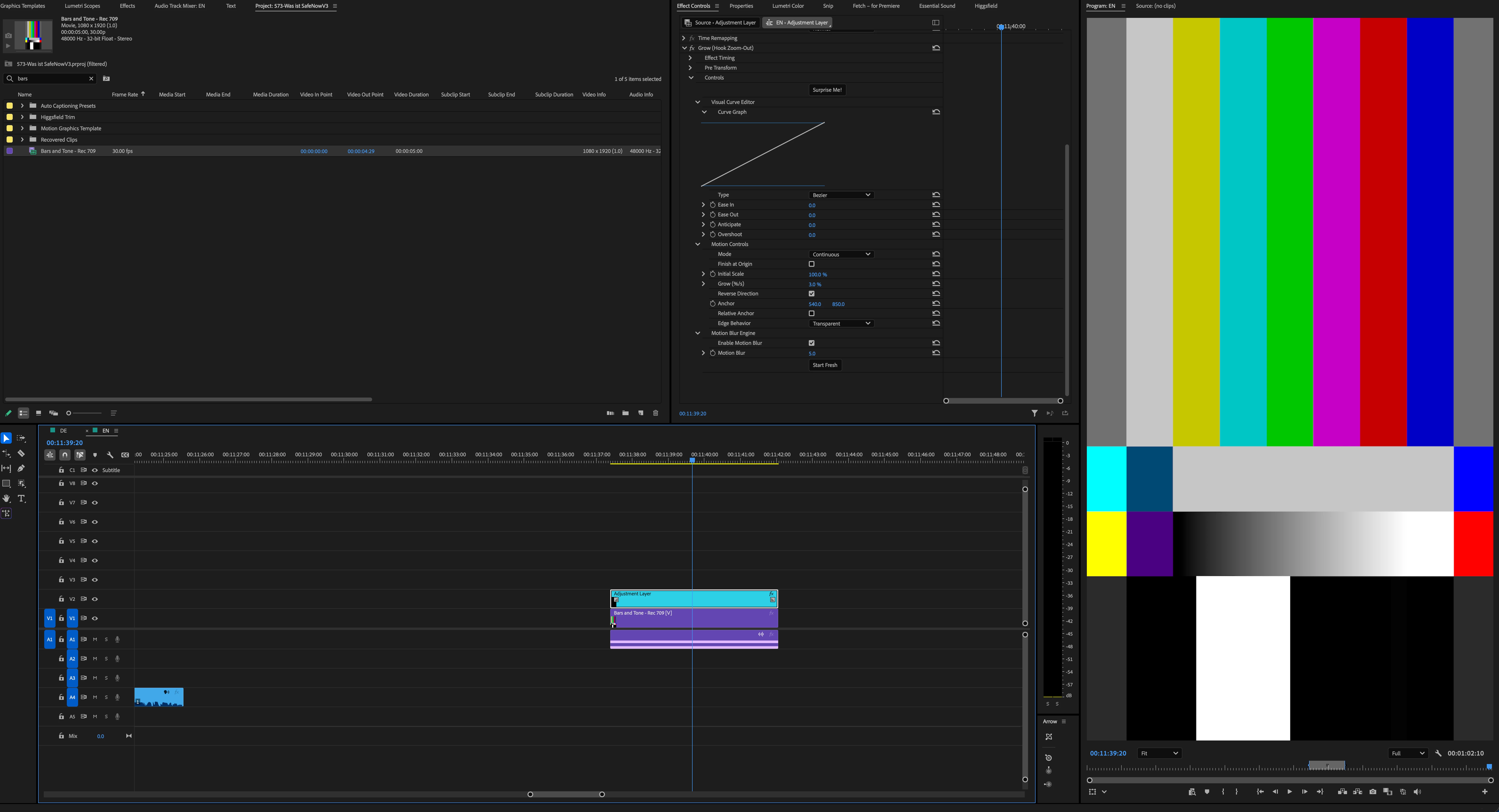

    Adjustment Layer with “grow” effect and no rate stretch, Grow effect acts as expected.
    Adjustment Layer with “grow” effect with rate stretch, “grow” effect just zooms in a lot.

    I know that it shouldn't do anything to an AL but it does. It does not seem to effect any properties on the AL exept for the new duration based film impact effects…
