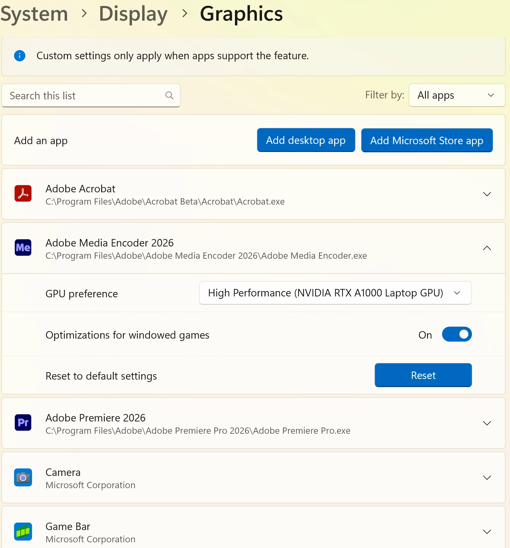

    Just to confirm, have you tried forcing Premiere to use your dedicated GPU in System Settings → Display → Graphics
    You might have to add the Application Here.
    This shows Media Encoder, but you can set it for Premiere too
    My screenshot shows Media Encoder, but you can set it for Premiere too.
    Please let me know if this resolves the issue or you already tried it.
