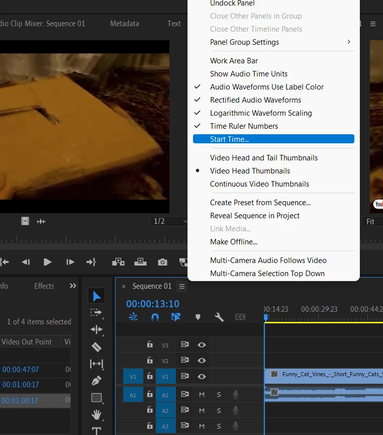

Sep 11, 2023 12:09 PM UTC
Good day, @daapap
Do you want to arrange the clip's start timecode to be in order?
Select "Start Timecode" option from the Timeline Humberger menu, then change the Timecode value to a desired value. If you open the sequence on any monitor or export a clip, the start timecode value will be visible.
I hope this is what you were seeking! Inform us.
thanks,
Suraj.

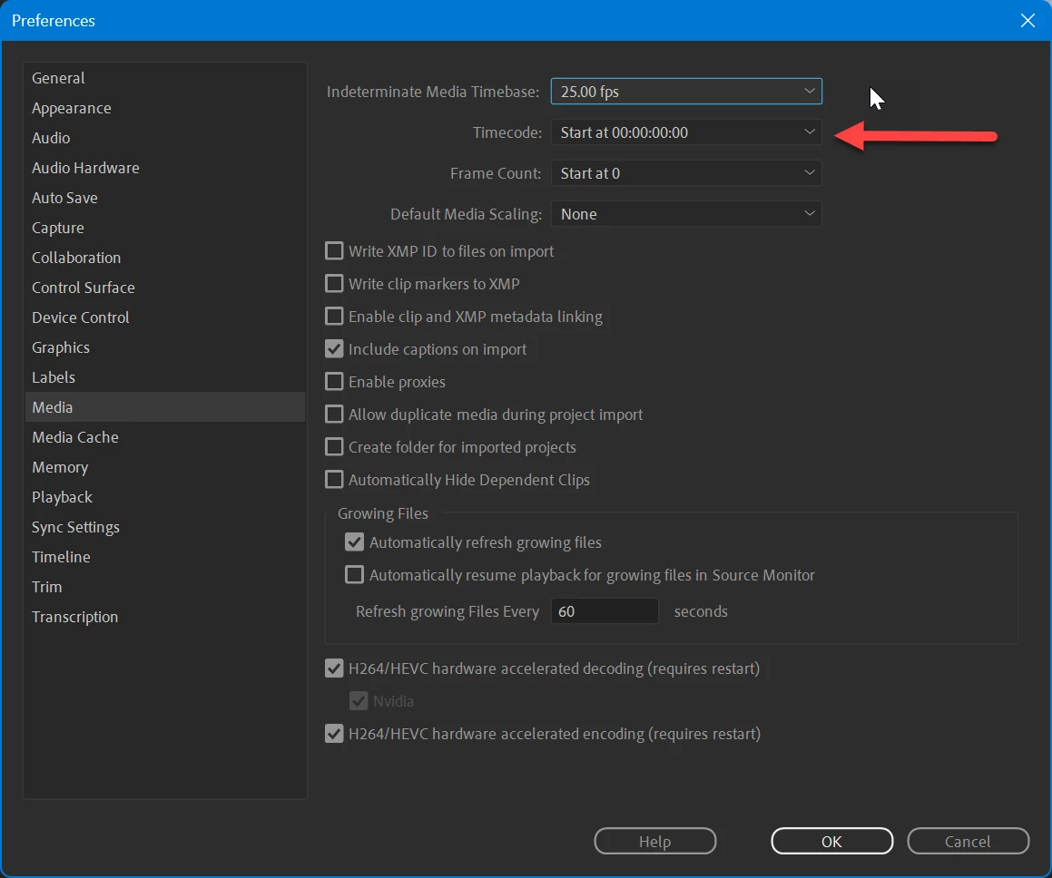

Ann Bens
Sep 11, 2023 9:52 AM UTC
Change the setting.
