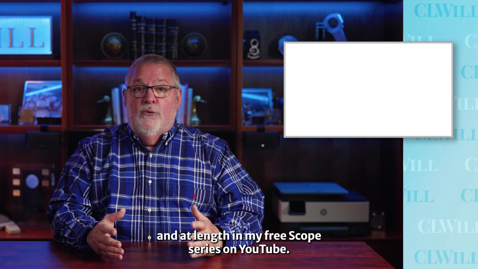

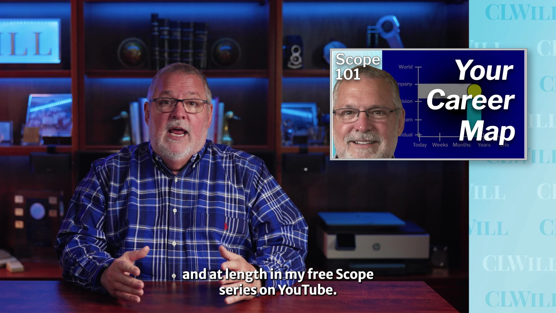

Aug 30, 2024 6:43 PM UTC
For quick reference here's two screen shots. First in PP, second from AME.
