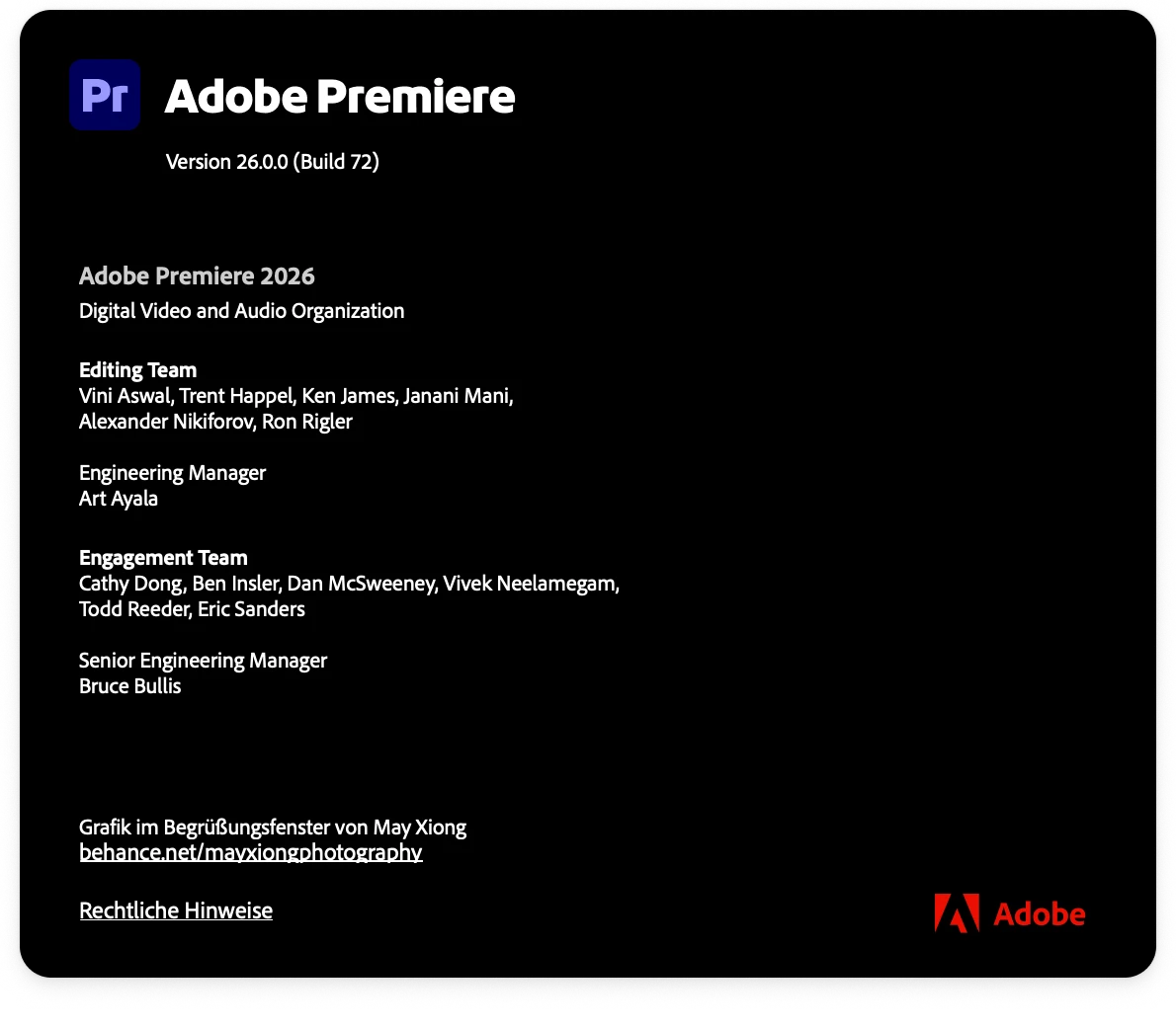

 HI ​@Lukas Sander,
Thanks for reporting this issue. That is not expected behavior.  I’m sorry you’re dealing with it.  Are you able to capture a screen recording of the issue?  Also, can you tell me exactly which version of 26 you're using, along with your computer specs?  Please see: How do I Report A Problem?  I hope we can help you soon.
Lukas Sander
February 12, 2026
thanks for the reply! this is what I am using:

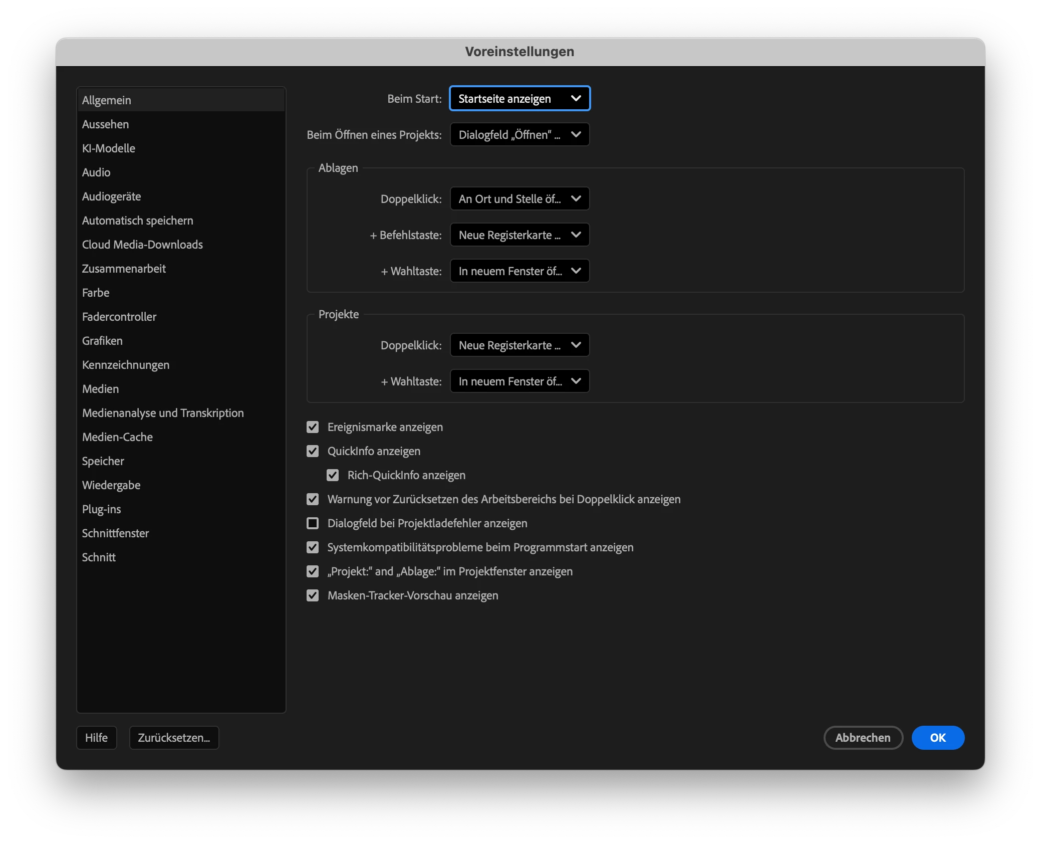

and this is what it looks like - not really interesting. the settings page before the click on “OK”:

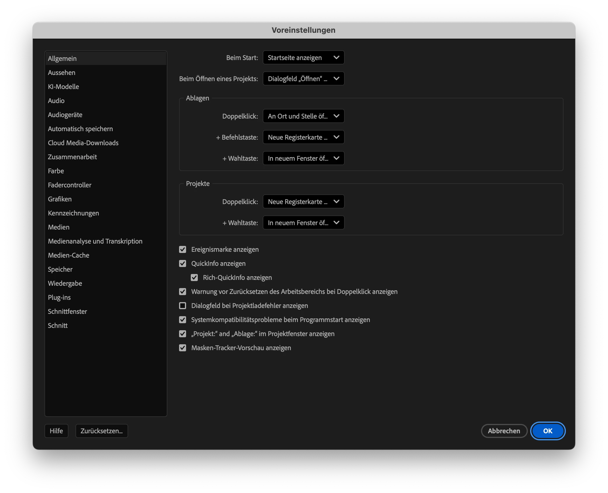

and after the click it just stays there with the highlighted “OK” button:
it doesn’t matter if I change anything or not - the “OK” never works. it doesn’t freeze - I can change things afterwards, but the window only disappears with “Abbrechen” (cancel).

problem was solved in a long session assisted by google ai resetting preferences, deleting caches,  deleting prefernce files, going to console mode, using the adobe cleaner tool, deleting host files,  checking logitech overlays, blocking background tasks in terminal...
finally it came down to read and write settings of the premiere folder to which the settings save the data (~/Library/Preferences/Adobe/Premiere Pro/26.0/). why the rights to read and write were changed one day to the next stays mysterious...
