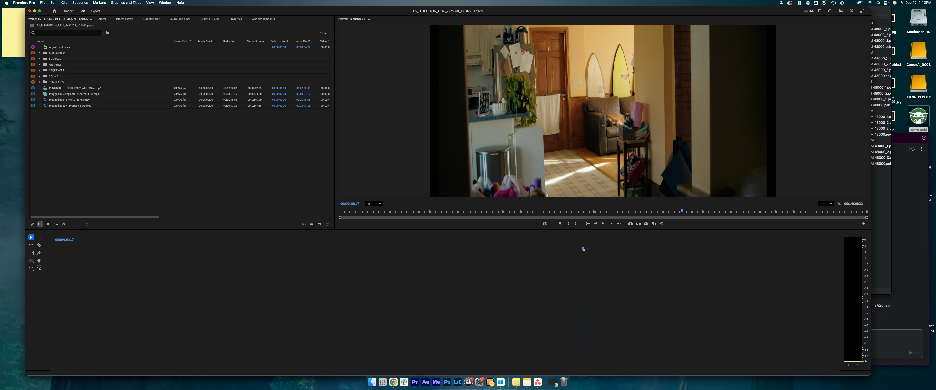

I’m experiencing an issue when using Canon Cinema RAW Lite footage from the EOS C50 on my MacBook Pro M4 Pro running macOS Sequoia. Playback in Premiere Pro 25.6.x works correctly, but when pausing the timeline, some frames display black or magenta bars on teh bottom of the actual frame.
System Details:
  • Mac: MacBook Pro M4 Pro - Sequoia (latest build)
  • Premiere Pro: 25.6.3 (Build 2)
  • Canon Camera: EOS C50 Cinema RAW Lite (.CRM)
  • GPU Acceleration: Metal 3 (20-core GPU) [have tried other settings too]
  • RAM: 48 GB, Storage: 512 GB SSD System Firmware Ver: 13822.41.1  OS Loader Ver: 11881.140.96
    Additional Notes:
    • Occurs only with Canon RAW Lite from EOS C50. BRAW has no uased frame issues
    • Does not occur in Davinci Resolve
    • Playback in Premiere is fine — issue appears only when pausing playhead
    • Happens in Premiere Pro 25.6.3 and 26.x Beta
I'm loving the c50 and while the proxies workflow does work, it's not the efficiency I expect from Premiere. Please can someone restore my sanity..I'm far too old to learn Resolve as well as I know Premeire Thanks

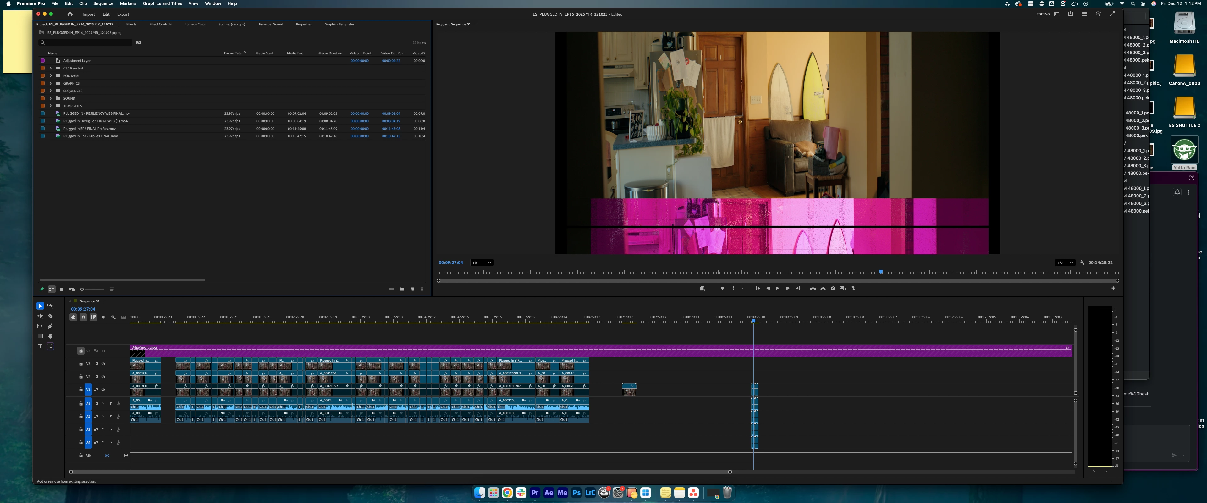

Having the same issue with my C50, I've tried Raw LT, ST, and HQ in 4k 16x9, as well as 4:3 open gate modes. The files actually cause Premier to glitch on the UI as well. See the magenta bars while paused, and the timeline dissapearing when playing except for directly on the playhead. The magenta bars/missing bottom portion of the frame persist when rendering & exporting as well, so it's not just a playback issue.

Here’s the full bug report below and a A sample .CRM is being sent via WeTransfer to the same address above along with a screen recording:
Issue
Canon Cinema RAW Light (.CRM) footage from the Canon C50 shows severe display corruption in Adobe Premiere Pro 25.6.x on macOS Sequoia (M4 Pro).
Two symptoms occur:
Paused frames frequently display black or magenta bars instead of the actual frame.
Playback intermittently breaks, showing the same black/magenta block artifacts, even at 1/4 resolution or any playback setting (Full, 1/2, 1/4, 1/8).
Playback sometimes resumes normally after a few seconds, but paused-frame display is consistently unreliable.
This occurs only with Cinema RAW Light, and only inside Premiere Pro.
Steps to Reproduce
Create a new Premiere Pro project (25.6.3).
Import Canon C50 Cinema RAW Light (.CRM) files.
Place a clip on the timeline.
Start playback.
After a few seconds, pause playback.
Observe the Program Monitor.
Resume playback and continue watching—after several seconds, corruption may appear again.
To confirm it is not resolution-related:
8. Change playback resolution between Full → 1/2 → 1/4 → 1/8.
9. Observe that the corruption still occurs regardless of resolution.
Expected Result
Paused frame shows the correct image, identical to playback.
Playback remains stable at any resolution.
No black bars, magenta blocks, or corrupted overlays.
Actual Result
Paused frames frequently show black or magenta bars covering part or all of the frame.
Playback sometimes shows flickering black/magenta blocks even at the lowest playback resolution.
Playback itself is generally smoother, but visual corruption appears without warning.
Audio playback is unaffected.
Exports are correct (the issue appears only in Premiere’s viewer).
Screen Recording
(Attach when submitting)
Shows:
RAW Lite clip playing correctly
Pausing playback → immediate corruption
Changing playback resolution → corruption persists
Short examples of playback breaking during continuous play
Adobe Premiere Pro Version
25.6.3 – Build 2
(Same behaviour tested in Premiere Pro Beta 26.x)
Operating System
macOS Sequoia (latest available release)
System firmware and loader versions:
Firmware: 13822.41.1
OS Loader: 11881.140.96
System Hardware
MacBook Pro 14" – M4 Pro
48GB RAM
512GB SSD
Apple M4 Pro CPU
Apple M4 Pro 20-core GPU
Metal 3 graphics subsystem
Fully updated macOS
Video Format
Canon Cinema RAW Light (.CRM) from Canon C50.
Issue does not occur with:
ProRes 422 / HQ
H.264 / HEVC
ProRes proxies created from the same files
It seems the bug is isolated to Canon Cinema RAW Light decode on Apple Silicon M4 Pro.
Comparative Information
Does it affect all projects or only some?
All projects containing Cinema RAW Light (.CRM).
Even brand-new empty projects reproduce the issue.
Does it affect new projects?
Yes — creating a new empty Premiere project still reproduces the corruption.
When did the problem begin?
It was present from the very first installation of Premiere Pro 25.6 on this M4 Pro Mac running macOS Sequoia.
Also confirmed in current Premiere Pro Beta 26.
Additional Notes
.BRAW files display fine
DaVinci Resolve displays and plays Cinema RAW Light flawlessly on this hardware.
Exported files from Premiere Pro are not corrupted.
Problem appears to be specifically in Premiere’s RAW decode → GPU display pipeline on Apple Silicon M4.
