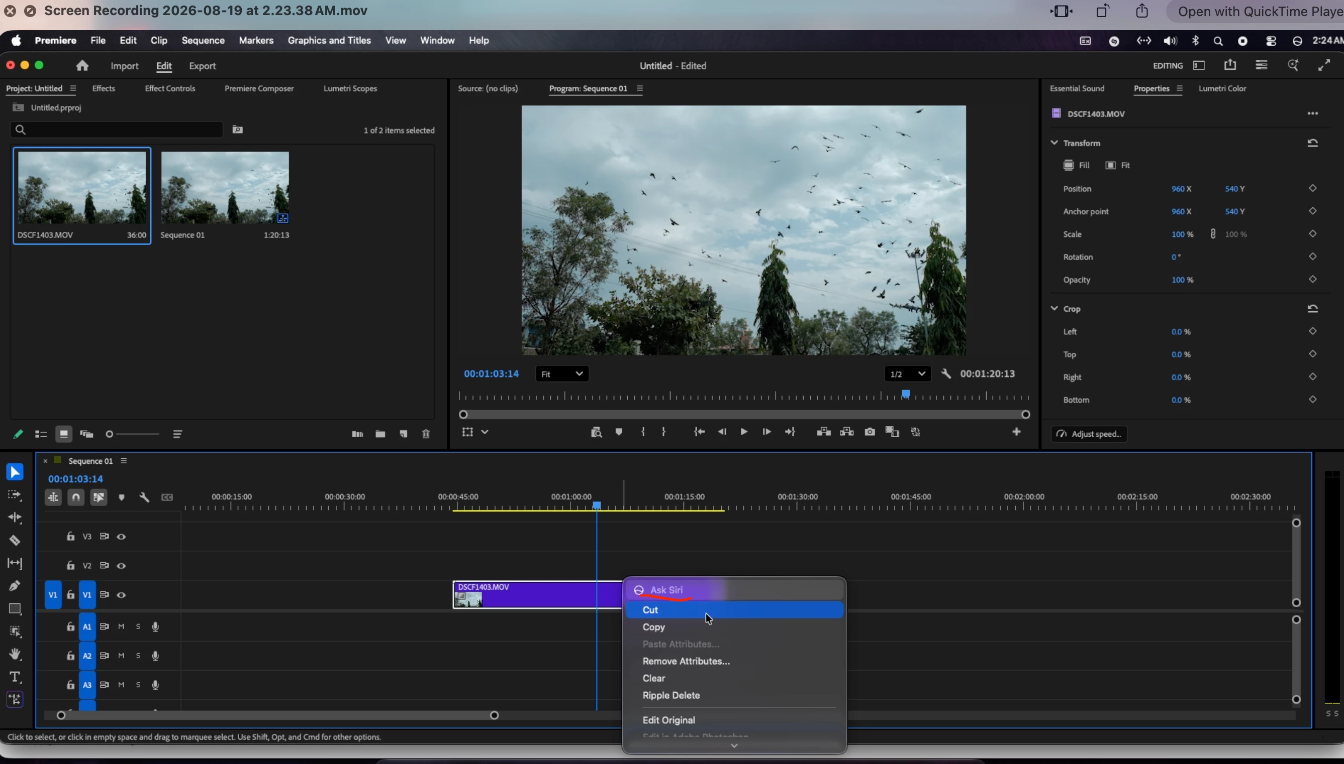

P: Premiere freezes when a submenu is opened from the timeline clip right-click menu (Label to Time Interpolation). The submenu highlight sticks and the UI stops repainting.
Premiere Pro freezes completely whenever I open the Time Interpolation submenu from a clip’s Timeline context menu. The freeze happens immediately when I hover over/open Time Interpolation — I do not need to click Optical Flow for the freeze to occur.
I first noticed this in my existing project, but I tested it again in a completely new project with only one video clip, and the exact same issue occurs.
Steps to reproduce:
  1. Create a new Premiere Pro project.
  2. Import a single video clip.
  3. Add the clip to the Timeline.
  4. Right-click the clip.
  5. Hover over/open Time Interpolation.
  6. Premiere immediately becomes unresponsive and needs to be force-quit.
I have also tested after disabling third-party extensions/plugins, but the issue still occurs.
System: Apple Silicon Mac, macOS 27.0, Premiere Pro 26.0.2.2.
I have attached a screen recording showing the issue. I can also provide an Activity Monitor sample taken while Premiere is frozen if needed.
    Pinned Reply By KatieToo
    ​@Athul S Keerthi Just to update your post for all, we’re aware of this ‘Ask Siri’ issue. The current workaround is to disable Ask Siri.
    We’re currently working on a fix, and we will return here to update once that becomes available.
    Thanks again for taking the time to report on this and helping others!
    Katie

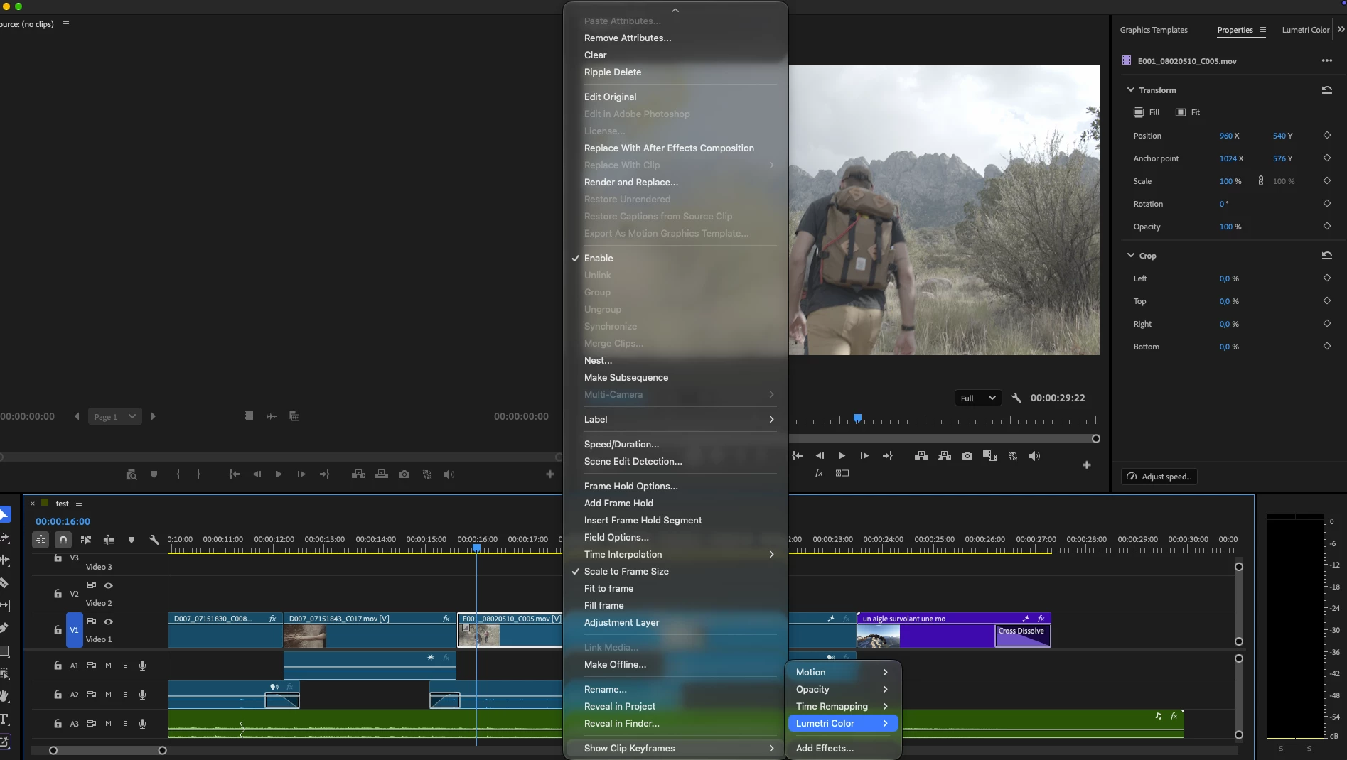

    Sep 25, 2026 3:14 PM UTC
    I am experiencing the exact same issue.
    Whenever I right-click a clip in the timeline and navigate down the contextual menu (specifically hovering over flyout submenus like Show Clip Keyframes > Time Remapping / Lumetri Color / Motion), Premiere Pro completely freezes and hangs immediately, forcing me to Force Quit.
    in my case, this consistently happens in a multi-display extended desktop setup (MacBook Pro internal display + 2 external monitors). It seems like rendering nested context menus across mixed-DPI / multi-monitor workspaces may be triggering a UI thread lockup.

    KatieToo
    Sep 25, 2026 4:27 PM UTC
    ​@manele68 Thank you for this report! So then, you don’t also have Ask Siri enabled in your right click menus? I see your screenshot attached but it’s scrolled down. That would be showing up right at the top of that right click menu if it was present. The other two are experiencing Ask Siri related issues here, on one monitor.
    Let us know, and also I’ve highlighted the instructions on how to disable that Ask Siri in menus on this post to help as workaround for now.
    I’m not sure what is causing the crash between QT Player and Premiere, however, if you’ve got similar shortcuts, hitting CMD SHIFT 5 together brings up built-in screen recording if you’re able to capture that.
    Sorry for the frustration with this!

    Sep 25, 2026 5:49 PM UTC
    Hey, thanks for your quick response! That was indeed the problem. Turning off 'Ask Siri' in the right-click menu fixed it, and everything is back to normal!
