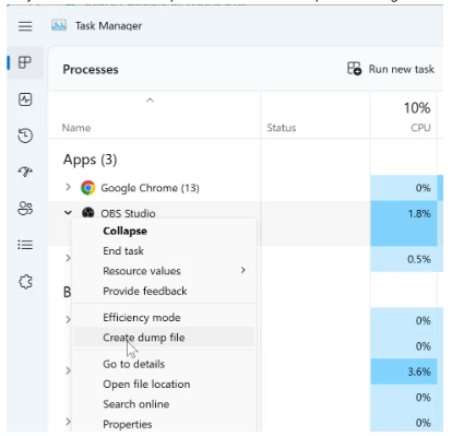

May someone who is impated by this issue provide NVIDIA with a dmp file after the application becomes unresponsive. Here are the steps to provide the dmp file :
Creating a manual crash dump file when a program freezes or is unresponsive
When you are using a program and it becomes unresponsive, you can manually create a dump file using the Windows Task Manager.  Choose from one of the two methods to access the Windows Task Manager.
a) Right-click over the Start icon or Windows Taskbar and select Task Manager from the context menu.
b) On your Windows keyboard, press CTRL + ALT + DEL at the same time.  Then select Task Manager.
This will bring up the Windows Task Manager.  Find the process for the program that is frozen or unresponsive.  Next, right-click over the app and select Create dump file (if you do not see the option, drill down on the app and find the process which is unresponsive from the expanded list).  It may take Windows a couple of minutes to complete writing the dump file.
Once Windows notifies you that the file was successfully created, select
Open file location.  The DMP file will be too large to attach to an email.  You will first need to upload the DMP file to a file sharing service such as Google Drive or Microsoft OneDrive and then share the URL to download the file with us.  You may reduce the file size by compressing or zipping up the file before uploading it to a file sharing site
