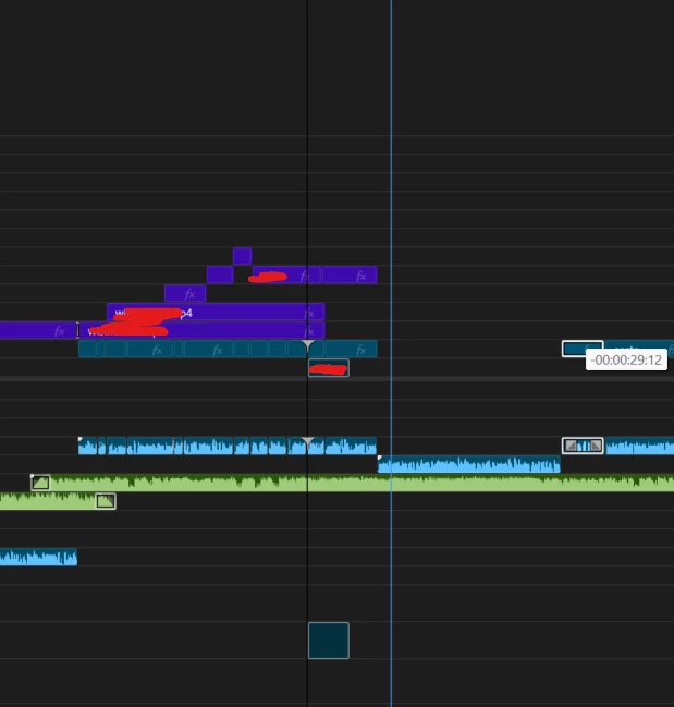

P: Unable to freely move clips and audio around on my timeline. Glitch, bug or setting?
If anyone is able to wave a magic wand and help me fix this issue then I would be so very grateful!
I am using Premier pro 25.1 on a windows PC, I opened up my project the other day to start work and I was unable to freely click on a clip and drag the clip about on the timeline with the same thing happening with audio. When I do click on a clip to move or drag it I am presented with the picture I have attached, in my program window.
I have tried everything on nearly every forum page I can find, reset all settings from splash, cleared cache, uninstalled and reinstalled softwear, new project, everything I can think of but I can't find anything anyway with someone with this same fault.

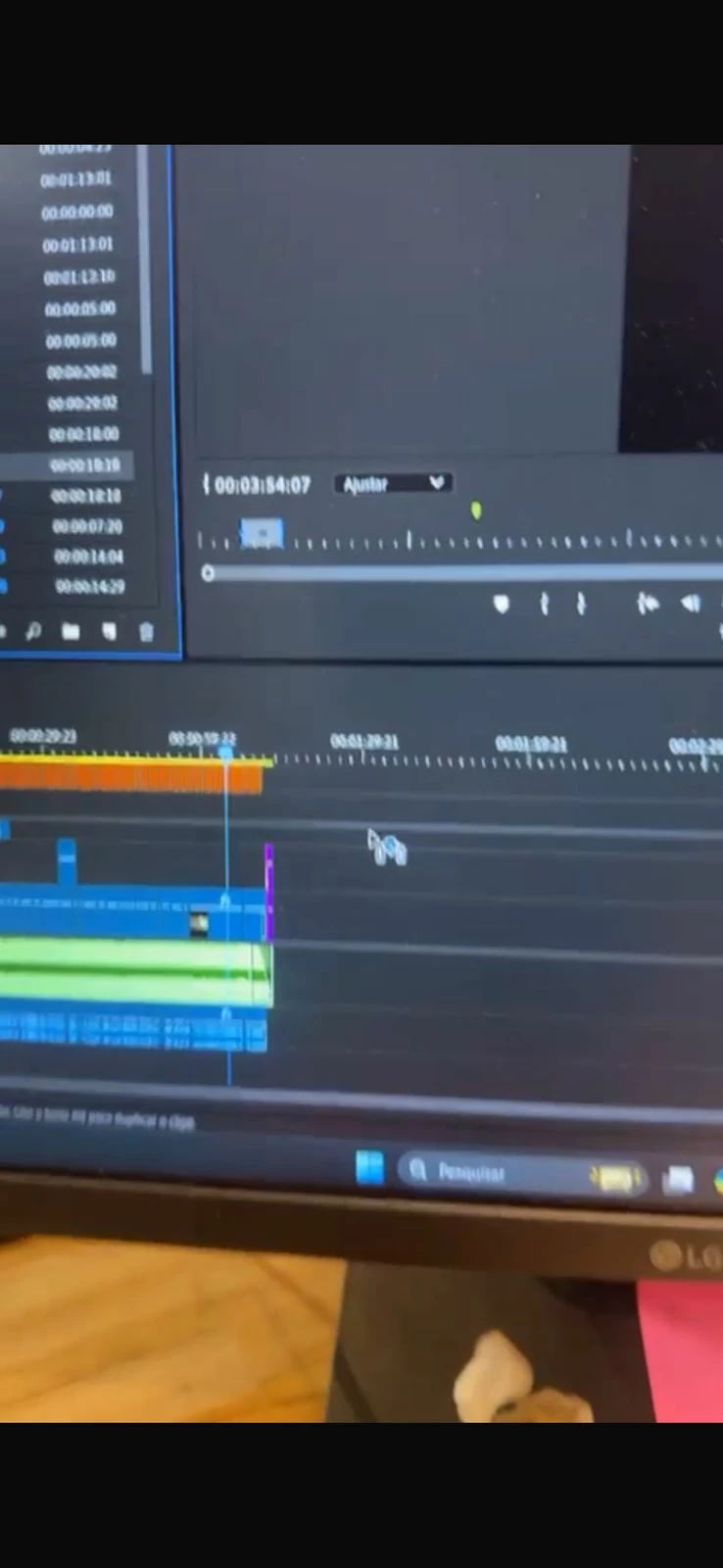

I need help.. So when I grab a clip video or audio in my timeline and move it, the clip get drag away like if my mouse was somewhere else. It's kind of hard to explain so I made a video. I tried unistalling Premiere, I updated it, reset my preferences, tried an other projet, tried downgraded to an older version, I updated my graphic card driver. Nothing works I don't know what to do next.. Please send help.

On 2/12/2025 PremierePro started acting strange. I can not drag clips on the timline and can not move them up or down to other tracks unless my mouse pointer is way off of where I want the clip to go. This is the case in both PremierePro and the Beta Version on my machine. I've uninstalled and reinstalled and still have the same issue. I've changed my mouse and no difference.

Feb 13, 2025 5:43 PM UTC
Please see the screen recording for the actual issue.
This happened after the latest NVIDIA Studio Driver update.
I rolled back the driver but the same issues resurfaced.
