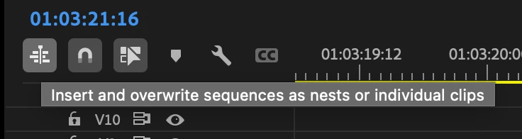

    When you are cutting the clips from your Synced sequence into your Edit sequence, do you have Insert and overwrite sequences as nests or individual clips? I’m wondering if your edited clips still reference that original sequence?

    I had “Insert and overwrite sequences as nests or individual clips” set to insert individual clips, not nests.
    The edited sequence contains separate camera and WAV clip instances rather than a nested reference to the original SyncMap sequence. I also confirmed this in the exported XML: the edit references the original media/master clips directly.
    Despite this, the WAV Source In/Out offsets became corrupted after saving, closing, and reopening the project.
