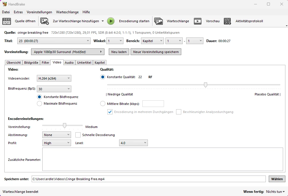

ich habe gerade versucht, mit diesen einstellungen (Siehe Anhang) es in cfr zu konvertieren und es klappt immernoch nicht. 

So the first group of videos is VFR ... variable frame rate, clear from 15 to 30 frames per second. That's an issue, as no NLE is really built for using VFR media. For editing, they need constant frames per second.
So try converting that in Handbrake to CFR, at "near placebo" to keep all quality. Then import the converted clips and see what happens.
