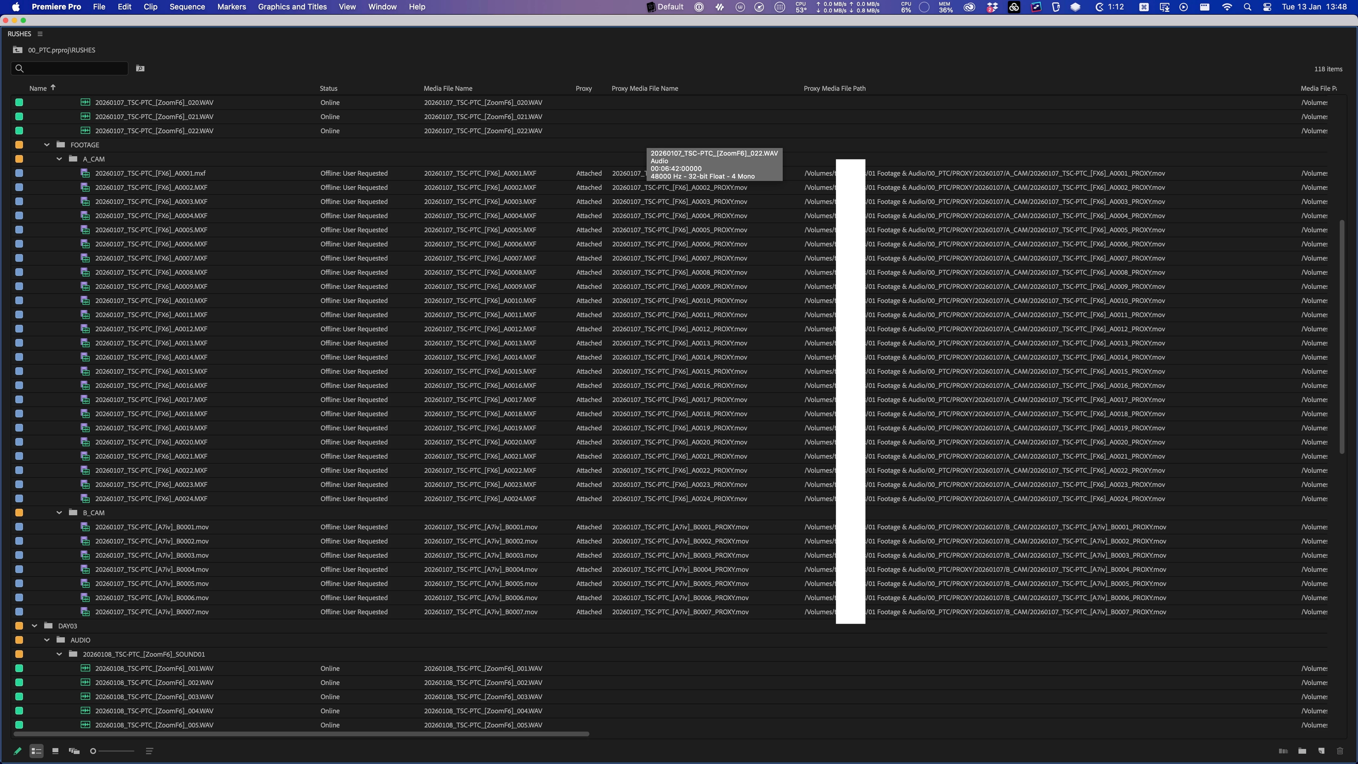

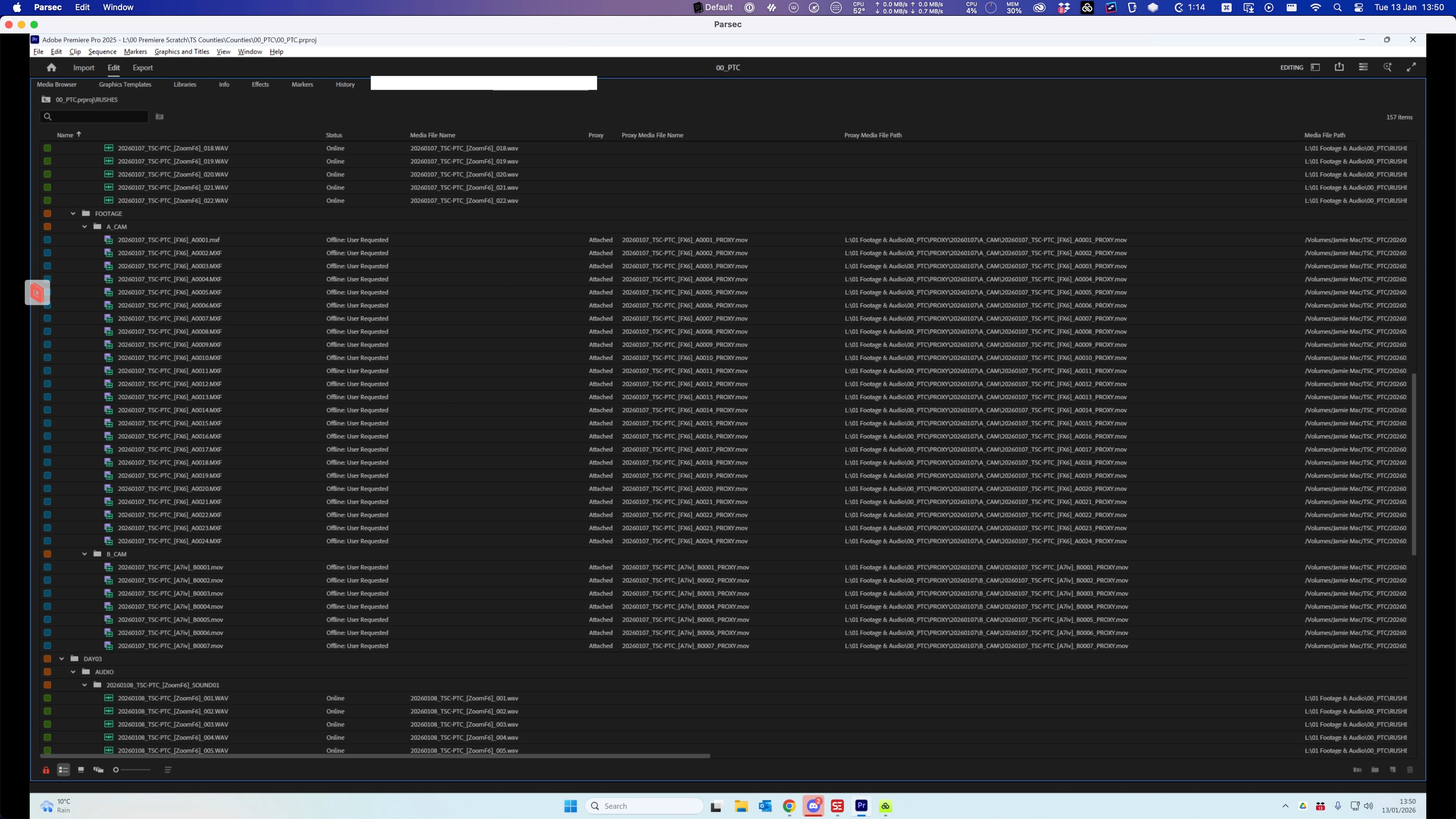

Jan 13, 2026 2:08 PM UTC
Hi @jamieclarke - thanks for the response.
Here's a screenshot for the same project on both Mac and PC (with LL Filespace name redacted).
Based on that article, we'd already changed the name of our LucidLink mount points, which LL support confirmed was the correct thing to do when I spoke to them.  They also said that this could be the possible cause of this issue, however, it didn't help and they didn't have any other immediate suggestions.
The team and I are up against various deadlines, so I'm not going to be able to pull together more info at the moment.  I'll try and sort more details later!
Thanks!
