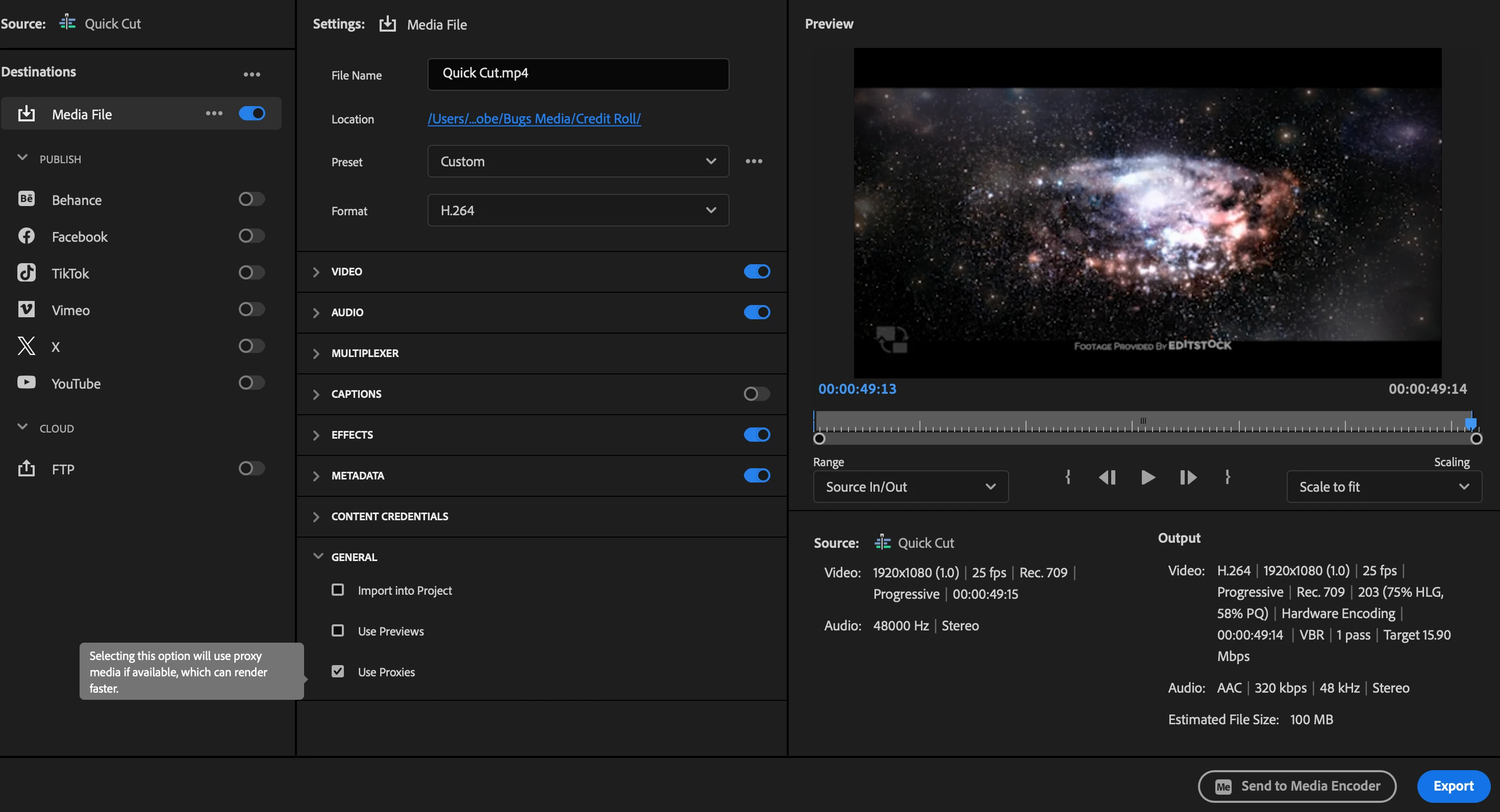

    As for exporting using proxies, this shouldn’t happen unless you have this checked in under “General” in the “Export” mode.
    Do you have this selected? The only other reason may be that it temporarily can’t find the source file, and will link to the proxy instead of exporting offline media, but that doesn’t appear to be the case. Are your Proxies and Source files on the same drive? (Conversely you could move Proxies to a separate external drive you can just unmount when exporting. They will still be attached but offline. I’d be curious to know if this acts as a workaround. )

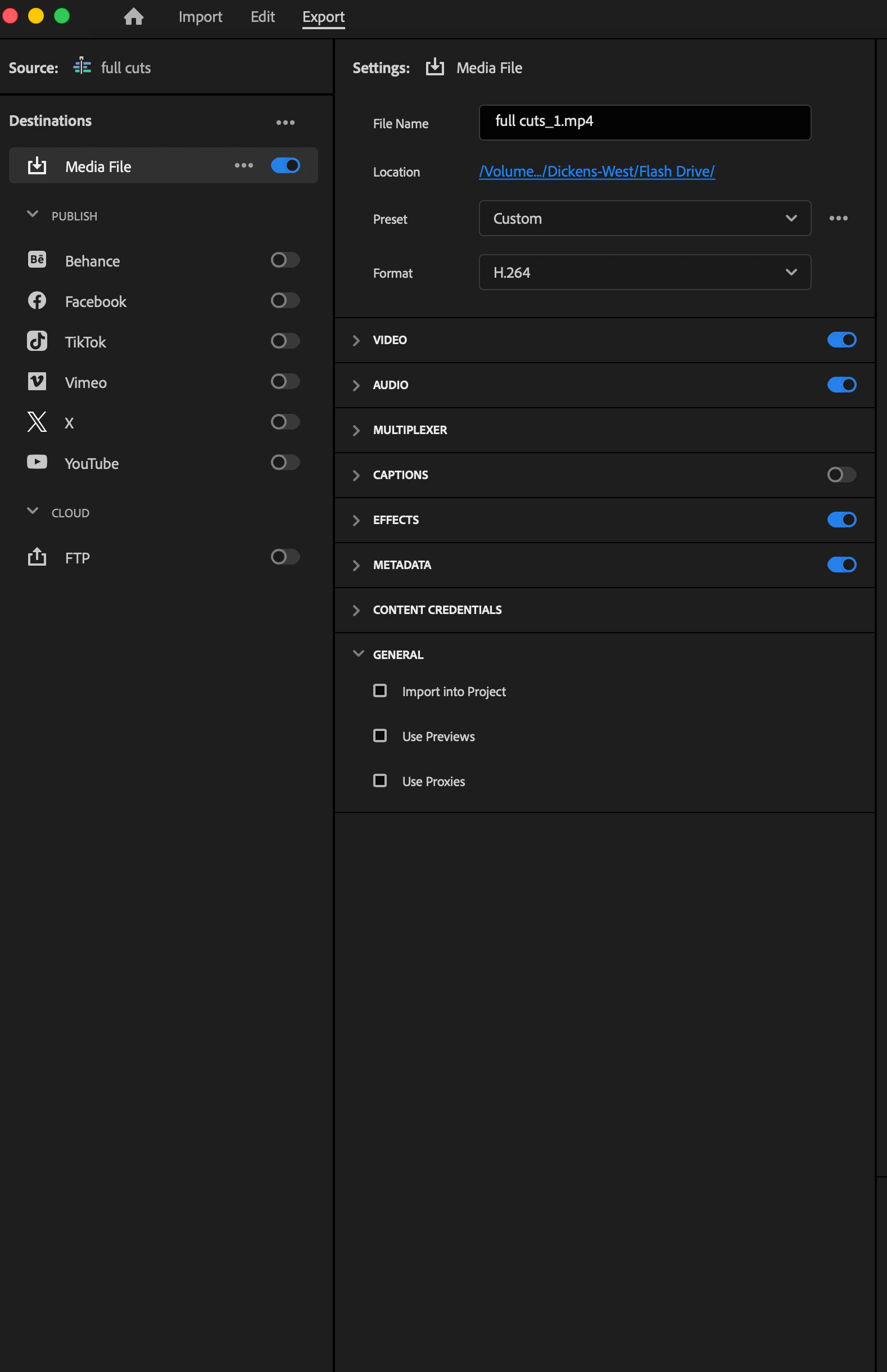

    No Amy, that is not selected. I’m aware of that box but it was not selected, I’ve specifically ensured that it has not been selected before every single export.

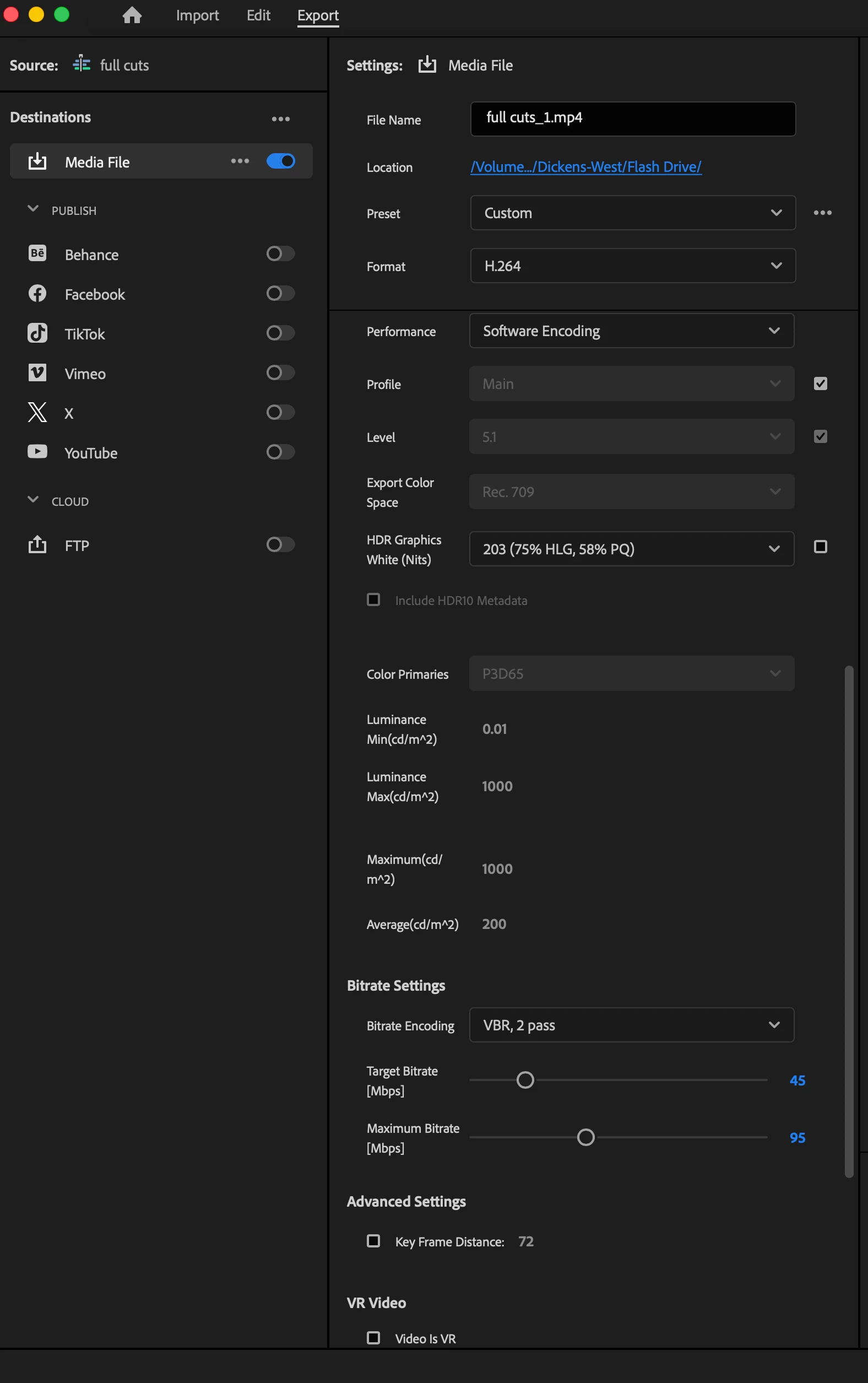

    I have my export settings at the highest quality, the same export settings I have been using for years. I have even started to toggle my proxies “off” before exporting.

    my settings for reference
