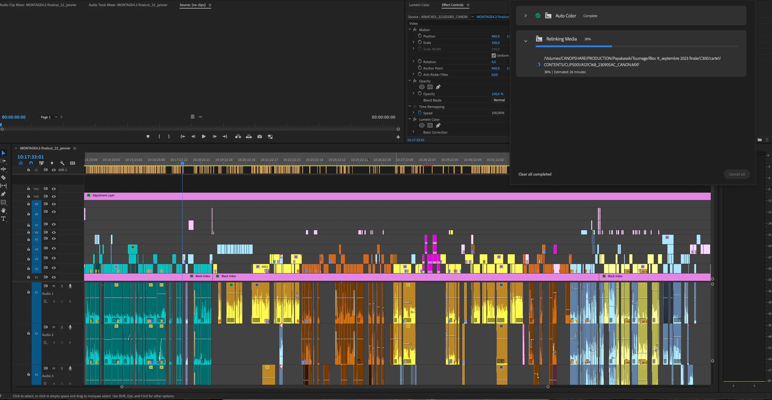

Premiere Pro takes a very long time to relink all medias when opening a project over a NAS.  It's in background but you can't really work on the project when medias are pending.  On smaller projects it's managable, but on feature lenght documentaries, it can take from 30 minutes to an hour to be ready.
The NAS is a QNAP TS-h1886XU, all the network is on 10gb, the NAS is connected to it's switch over a 20gb fiber link.  I'm working on a Mac Studio M2 Max.  I did a LAN test and I reach 5gbits in reading so it's fast.  The network dosen't seems to be the problem.
I also tried to copy all the project on a good old 4TB Hd, which is WAY slower than the network, and the project open fine.
I really seems that something in premiere is not working correctly when the files are over a network volume.  Is there something I can do on my side to speed up things?
By the way the volume is mounted on the mac via SMB.
Thanks for your help!
JPA
