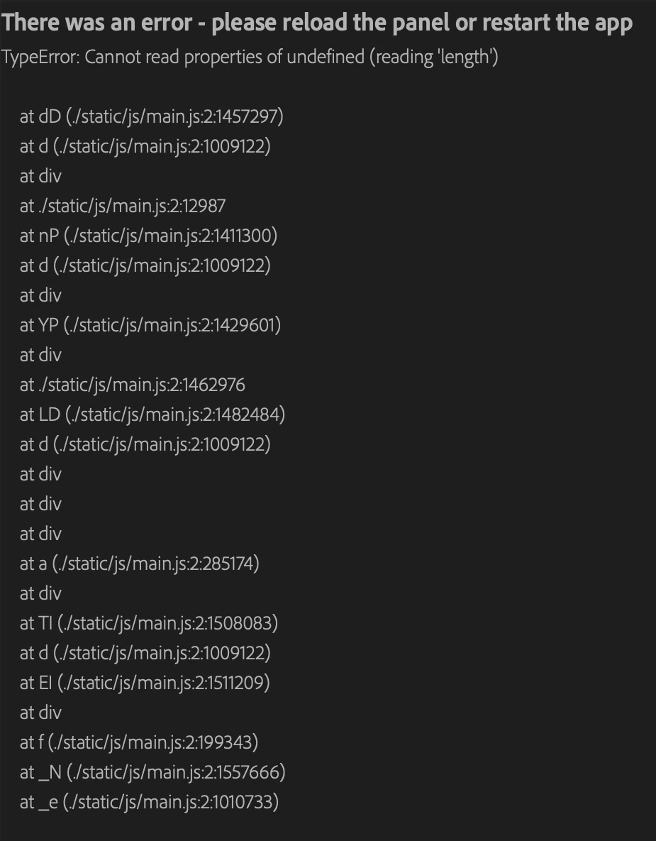

I've been using the new text panel to transcribe some source clips and it was stuck on one clip, so I left that sequence to work on another one while it did its thing. I reopened the text panel to this error message.
I restarted the text panel, then restarted Premiere, then restarted the computer, none of which worked. I opened the project on another system using the Productions project and the error persisted on their system as well. All of my previously transcribed clips were also affected and now the text panel doesn't work at all in this project. I brought the affected clip into a new project outside of the Production and the text panel recognised it, but trying to retranscribe it ends with the same error. There's nothing weird or corrupt about the clip itself. It plays and interacts with the NLE as normal. At an hour and 46 minutes long, it's on the longer side, but we have clips as long in the original project that Premiere had no problems with. It's a simple Q&A interview with one interviewer and one subject, so there's no action or multiple speakers to muddle the AI.
I haven't been able to replicate the issue with other clips, so I'm assuming it's a fluke, but I would love to know how to fix it so I don't have to trash an entire project that editors are working out of and relying on the script sync in the text panel.

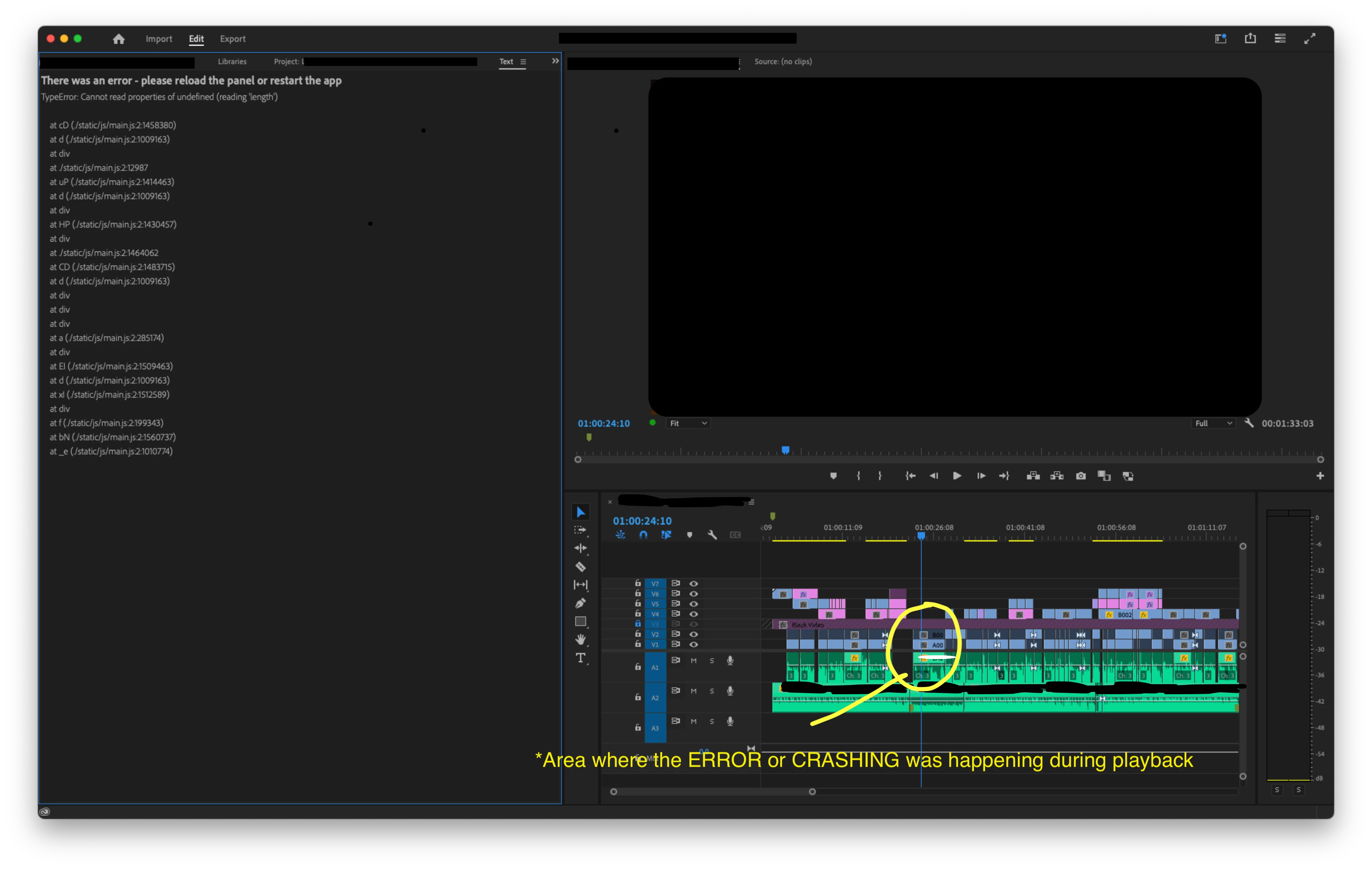

Prior system: M2 Pro Mac mini (19 core GPU; 32 GB RAM) - Ventura macOS
New system: M2 Max Macbook Pro 16" (38 core GPU; 64 GB RAM) - Ventura macOS
I have been working on a project that has been solely in PP 23.6.2 that has a few hours of interviews that have been "Text/Transcribed". No issues whatsover until today when I switched Mac systems. I was making revisions to a sequence and had the "Text" tab open to view the interview transcription details. The error mentioned in this post came up and eventually my system crashed. I was able to repeat this error and crash about 5-10 times.
I attempted multiple solutions: resetting workspace, offline/online (replace footage) for the clips and eventually entire project, reset settings, reset cache, and even tried opening the project in PP 24.0.3 and was still able to reproduce the issue of error message and crash.
My workaround fix that I stumbled across was pinpointing which audio/video clip kept producing the crash and deleting the moment from my sequence. I then went back and re-cut this clip from the Source Monitor into my timeline, and at least for this moment, I haven't had an error or crash using "Text/Transcription".
I'm not confident that this problem has gone away, and I wanted to share with the community to see if there's any details on why this is happening in both PP 2023 and PP 2024.

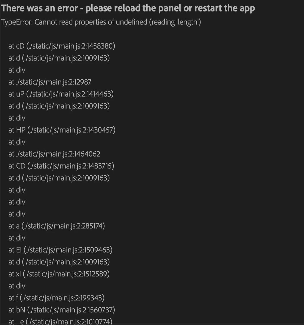

Oct 23, 2023 11:35 PM UTC
I've seen this error a few times now. Restarting the app has always fixed it for me so far but it would benice if Adobe could track it down. M1 Macbook Pro running V24 and using productions here.  It appears to be a javascript error. Adding screenshot for clarity.
