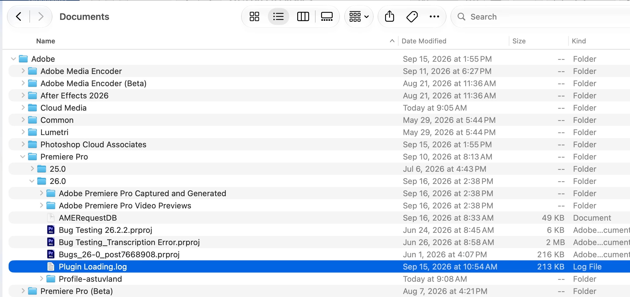

    Thank you for bringing this to our attention. I’m wondering if you had any of the older Plugin Loading.log files from when you had the spinning wheel of death. It would be in your Documents → Adobe → 26.0 folder. I also wonder, if you you do see this again, we could use a Sample file that could tell us what’s happening at the time of the hang. This should definitely not be happening.

    Sample file received. We would also appreciate the Plugin Loading.log file found at the following location: Documents → Adobe → Premiere Pro → 26.0
