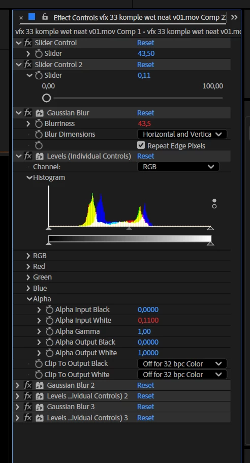

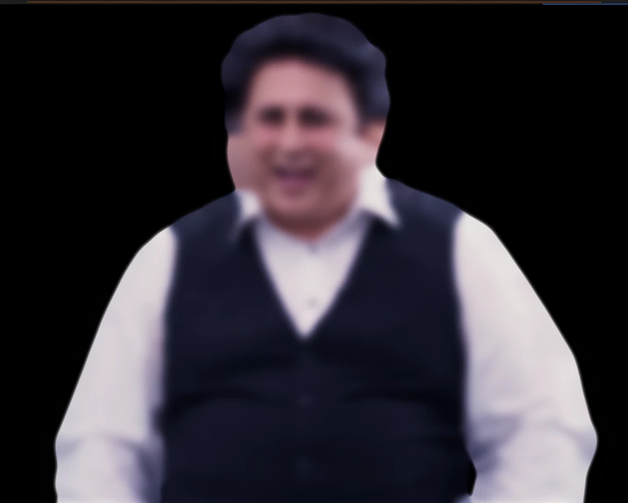

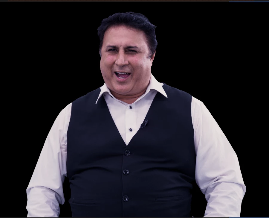

I think I solved the problem. I have been searching for this effect for a very long time aswell, and I can see you have asked the question in 2019 before. So here goes. I have 2 effects on the layer with alpha; 1 "gaussian blur", 2 "levels individual controls".
There are two different level effects in after effects, the first is "levels", and the second is "levels (indivual controls)". I used the second since I can keyframe (or rather parent values to a script) the "alpha input white" value. I put two sliders and parented these values to them; like this: "gaussian blur" to first slider, "levels indivudual controls > alpha input white" to the second slider. then I just dublicated the gaussian blur and levels effects a few times. So I have Gaus > Levels > Gaus >Levels > Gaus > Levels... controled by two sliders. I guess you can copy the effects as much as you want but it seems that 3 copies are suffient.
I am adding the effects stack, and the before after effects to an alpha image.
