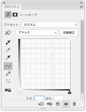

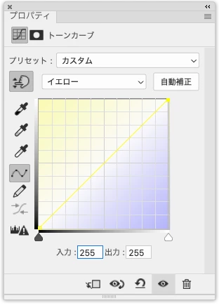

In the 26.11 release, the Tone Curve UI has become a mess. Inside the curve graph, there is an unnecessary gradient background that professionals don’t need, and there is no option to turn it off. More critically, in CMYK mode the Yellow and Black curves are almost completely invisible, yet this was released publicly. This really needs to be fixed.
Yellow channel curve in CMYK mode.
Black channel curve in CMYK mode (drawn in white, completely invisible)

Until version 2024, the curve colors in both RGB and CMYK modes were adjusted for visibility. For example, Yellow and Green curves had slightly reduced brightness, which made them distinguishable. In 26.11, however, both RGB and CMY curves are now rendered at maximum brightness (e.g. G255, R255+G255 for Yellow), with no consideration for visibility.
Additionally, in Light UI, the Black channel curve becomes completely invisible because it is drawn in white and does not adapt to the background.
On top of this, each channel now has unnecessary color gradients drawn in the background, which only makes the Tone Curve panel harder to use.

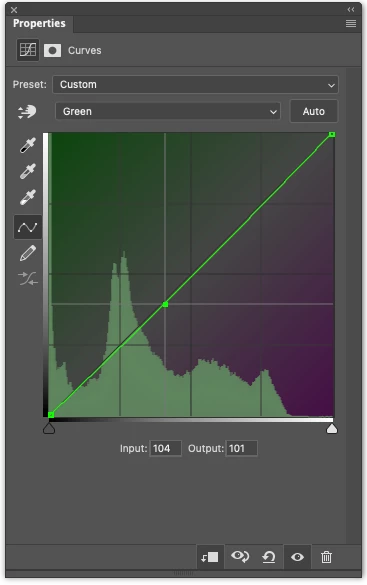

Just want to add another voice that this is extremely distracting. Good to know it's possible to turn it off, but while the color gradient is not useful, the histogram is, so I'd really rather not have to turn it off to get rid of the gradient. Please make two separate checkboxes!

Updated to 26.11 yesterday and a bit floored by the changes and lack of options. Is there really no way to hide this? The "Curves Display Options" let you turn off the histogram, channel lines, all kinds of things, but not the distracting colorful background.
