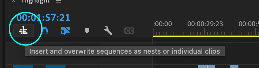

  • Bringing a nested sequence rather than UN-nested clips
    • Every time you bring a clip in your final timeline, Premiere defaults to bring a nested sequence rather than the clip's themselves.
    • So if you want your original clips flattened, you have to use, on every clip you bring from the source sequence, the "Multicam" option (see attached video). But then, the source audio/video are not linked anymore, which means that you need to relink them one by one.
    • It would be great to have an option to directly bring the clips from the source sequence to the working sequence using the selected patching. Rather than a nested sequence, which is more complicated to work with.Update : As @WellToldFilmCo commented, there is in fact a button to allow this. Thanks for the sharing, I'm now using it every day !

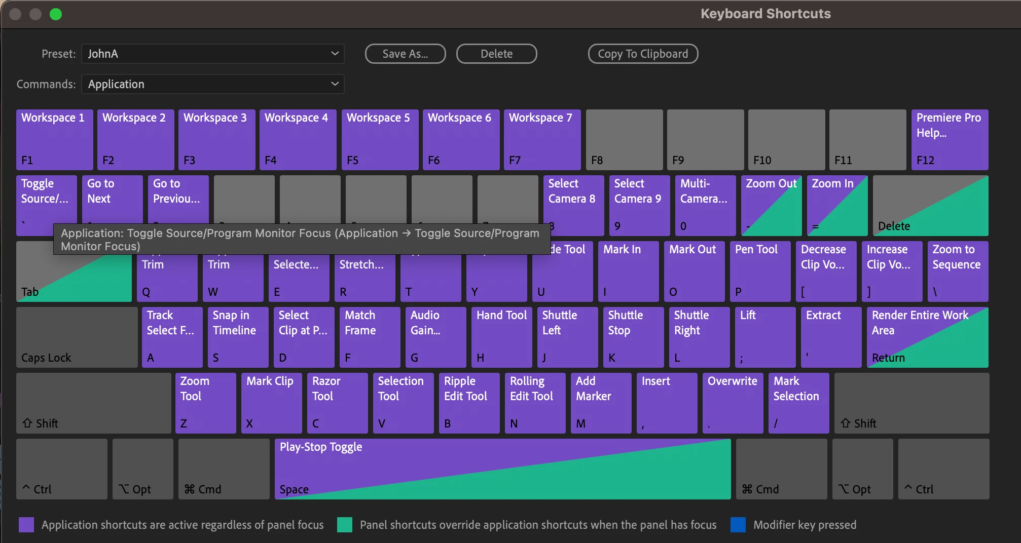

  • Define "Toggle Source/Program Monitor Focus" shortcut to an easily reachable key, let's say @
  • Define "Panels : Open Sequence" shortcut to an easily reachable key, let's say MAJ + @

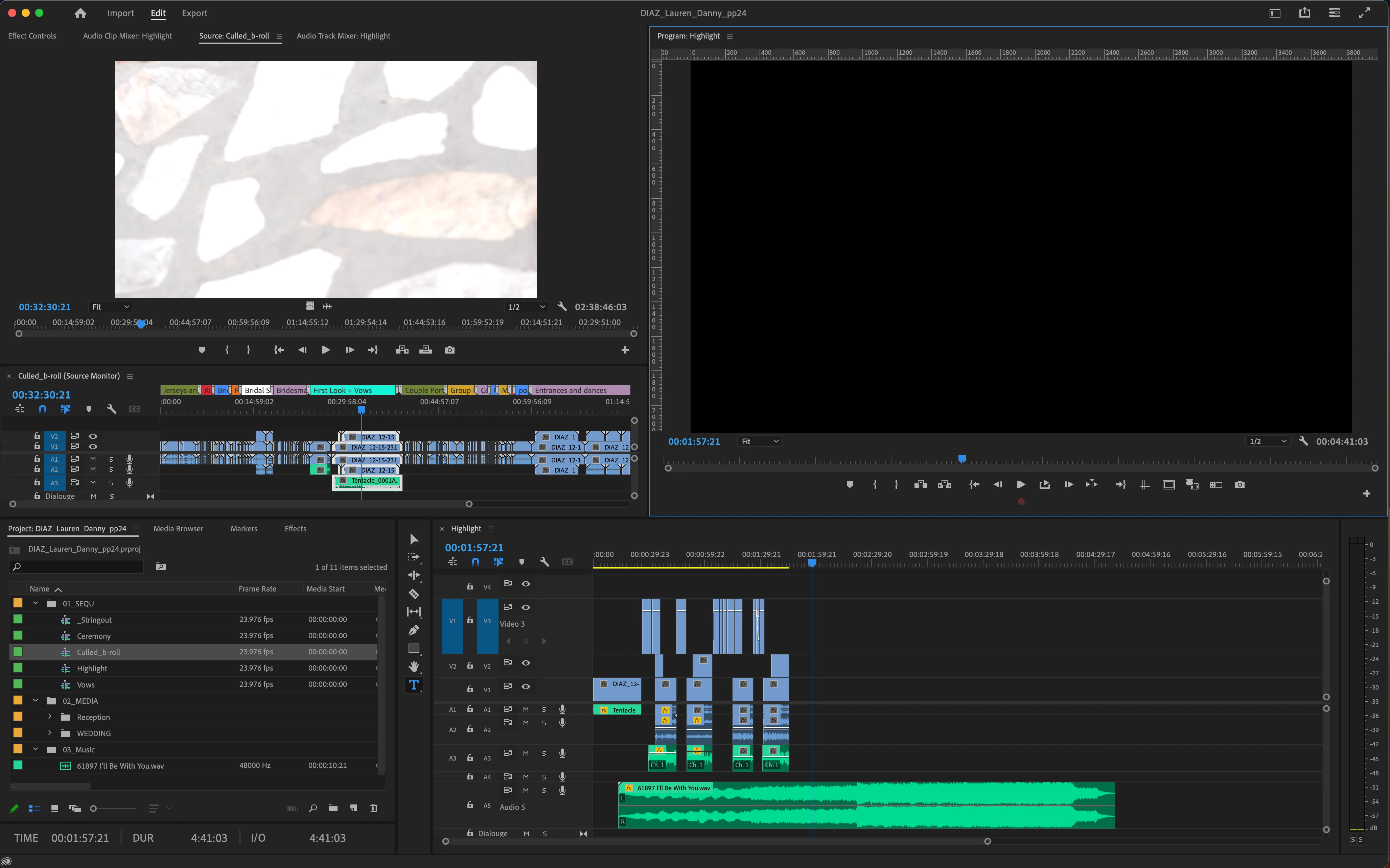

  • Drag a sequence into the Source Monitor, place the panel above your existing sequence.
  • Click on MAJ + @ to open it as a sequence.
  • Click on @ to continue working on your Program Sequence.
You have a video explaining that just below.

@WellToldFilmCoOh I didn't knew about this shortcut ! The issue is that you can work only with one source media at the time.
Or you would need to to the Toggle Source/Program shortcut and then the Pannels : Open Sequence everytime to see a visual representation of your source panel.
And I really like how you've put your source sequence underneath your source monitor, I think i'm going to switch to that ! I was used to having it stacked on my program sequence (like you would have on Media Composer), but that doesn't work well in Premiere since the shortcuts to toggle the source/program pannel does not changes the source/timeline you're viewing.
