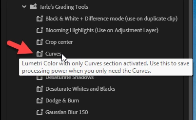

Jarle Leirpoll has a preset (and an idea) to save some processing power in his free presets pack available here:
https://premierepro.net/jarles-premiere-pro-presets-version-4/
This will lighten up Lumetri instances
