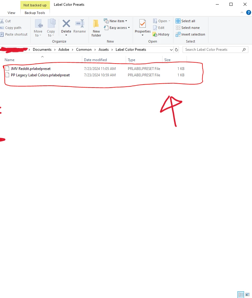

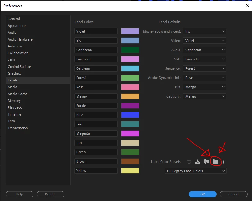

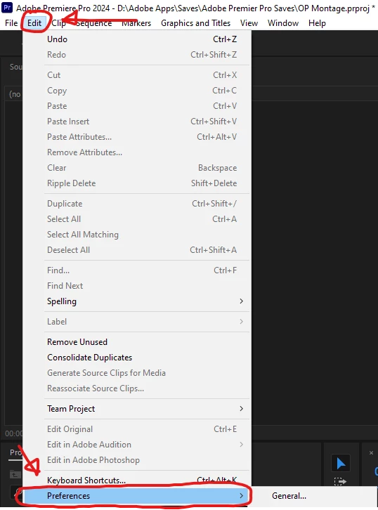

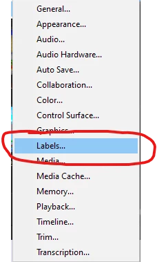

The best way is by using a preset. I have a preset made of the legacy colors: https://drive.google.com/file/d/1J8nUVIbwKHVx_17GZZX7R9PA7JcYEn-y/view
How to use preset:
You have to go to the "Edit" tab, and the go to the "Preferences" subtab.
More subtabs should appear, and then you should click on the "Labels" subtab.
Then, press on the little folder icon at the bottom:
Lastly, copy and paste the preset into the folder window that pops up:
Hope this helped! 🙂

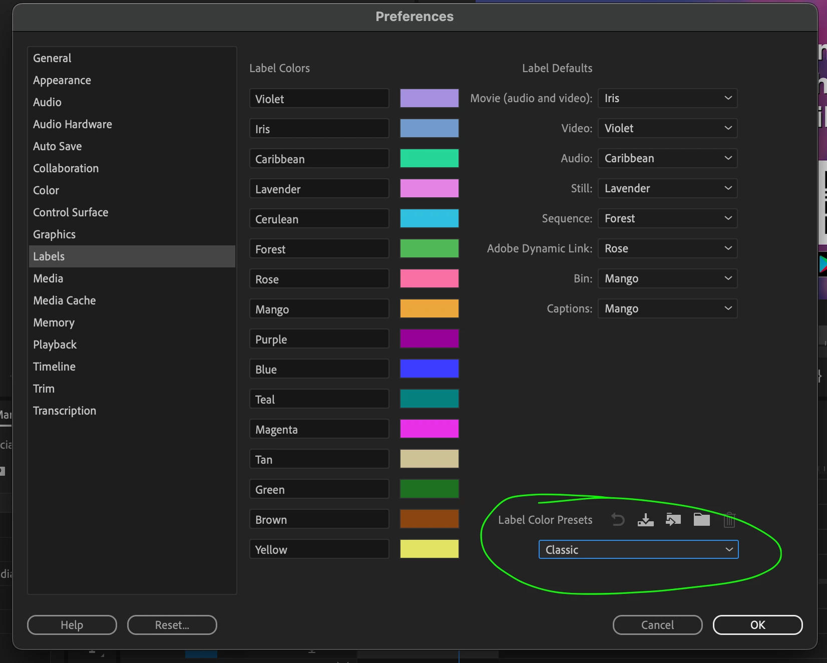

Go to Settings > Labels and you can switch the color mode to "classic."
I agree the new colors are way to muted, and Yellow and Brown are basically the same. I don't think these new colors are helpful at all, and I hope Adobe modifies the colors soon. Not sure how this would affect color blind users.

Here are the hex codes from the original color labels. Edit... Preferences... Labels... Copy and Paste
Violet                    A690E0
Iris                          729ACC
Caribbean          29D698
Lavender            E384E3
Cerulean            2FBFDE
Forest                   51B858
Rose                     F76FA4
Mango                  EDA63B
Purple                  970097
Blue                      3C3CFF
Teal                        008080
Magenta              E732E7
Tan                         CEC195
Green                   1D7021
Brown                   8B4513
Yellow                  E2E264
