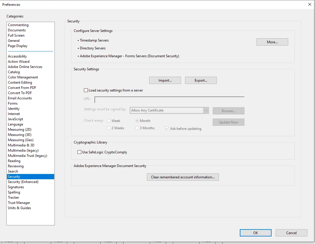

4. Can you please check the preference "Use SafeLogic CryptoComply" under Edit ->Prefrences -> Security". If the preference is enabled please uncheck the preference, restart the application and then try signing. Please let us know if this resolves the issue.

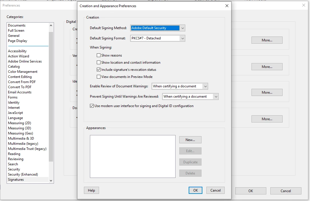

5. If the problem still persists, can you please try signing with Older UI. Preference to Enable the older UI.
Go to Edit -> preferences -> Signatures -> Creation and Appearance -> Uncheck use modern interface for Signing. Restart the application and now try signing. Is some error code visible when signing via old UI. Please share the error code if it comes.

4. i think we've gone through this setting and left it unchecked
5. can try this. never done it
