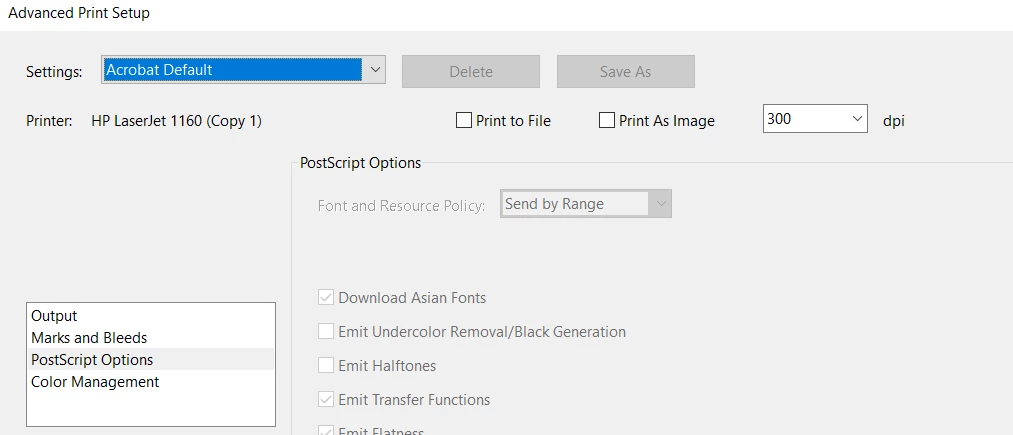

Dec 8, 2021 1:01 AM UTC
Hi! Just found a possible solution. Go to Advanced Print Settings, and un-check the box saying Print to File:
Good luck!
