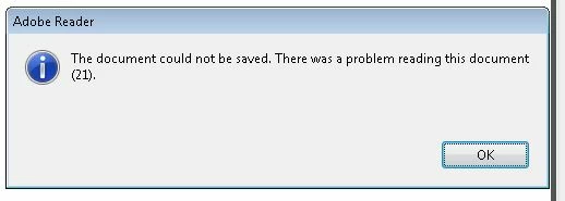

The PCs that have Reader 11.0.10 give the following messages on save as:
"The document could not be saved. There was a problem reading this document (21)"

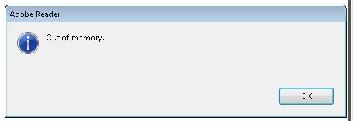

when I click OK to that error I get "Out of memory error"

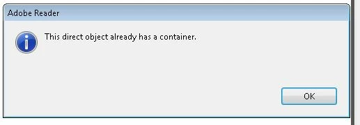

I read that holding down CTRL when clicking OK would give additional information, and it told me this: "This direct object already has a container"

January 7, 2015
Yes, we have it on multiple documents. As mentioned, they are reports that are generated from Microsoft Dynamcs AX. I have found out that not all reports get the error. PDFs from Office or  Autodesk AutoCAD do not get the error.
These are the errors it displays:
