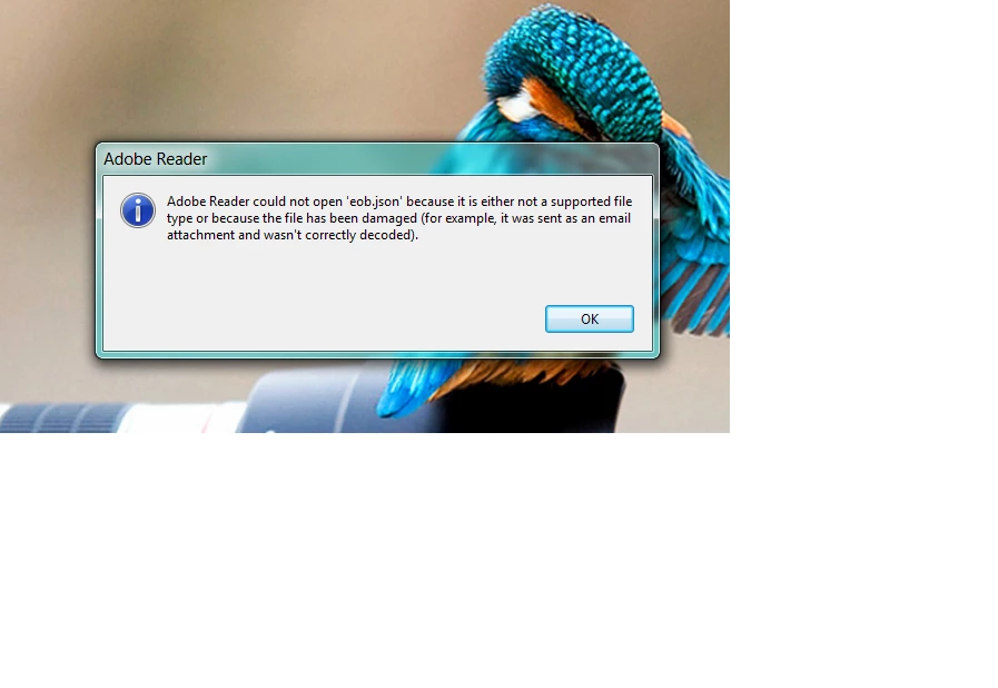

Error Message "Adobe Reader could not open...
I use my Adobe Acrobat Pro V10.1.3 print to the Adobe PDF printer to create all kinds of pdf files. One of my receipiants who gets these documents as e-mail attachments, gets the following error message when attempting to open those files:
"Adobe Reader could not open … because it is either not a supported file type or because the file has been damaged (for example, it was sent as an email attachment and wasn’t correctly decoded)."
This error message makes no sense to me, How can this be fixed?

  • Hi I am also facing the same Problem
  • While Opening the Doc

Same issue.  I have reinstalled Reader (three different versions).  I have ran the repair option.  Each time I try to print, I get this message.
Hopefully someone can advise as to a fix.

We have been having the same issue since 14/11/11 and thats not a typo
But is intermittent, some PDF's show as corrupt when some users try to open them but if they send the file to another user it can be opened.
Hopefully they find fix, I've been in communication with Ricoh and adobe to solve this and still no wiser to a solution.

E-mail attachments often get damaged during the transport; this is a very common occurrence.
Ways around it:
  • upload the document to a server (your own server, or Dropbox, Adobe Sendnow, Google Docs, ...), then send the recipient the link
  • put the document into a ZIP or other archive file before sending it
