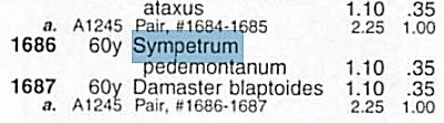

    In the below image, I can highlight a word which means adobe will find this word.

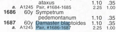

    In the below image, when I try to highligh Damaster, I get a double line highlight and adobe will not find it.
    How can I get a single line highlighted? Any help would be appreciated since manually searching through 1500 pages to find 1 stamp is very tiring.

    This is the result of creating a PDF from a page that was scanned at a poor quality and/or low resolution, and because of that the Text Recognition (OCR) process is not able to identify all the words in it correctly. Basically, unless you have access to the original pages and can scan them at a better quality, or to a better OCR engine, there's nothing you can do about it, especially not with the free Reader.
