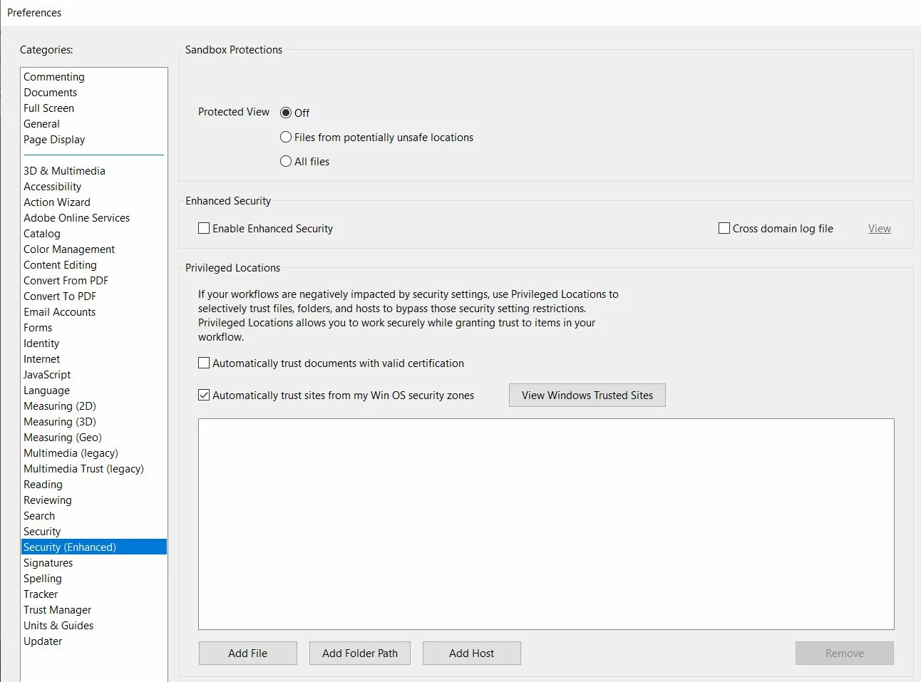

    Hi the option Edit-> Preferences -> Security (Enhanced) and check if "Run in AppContainer" does not appear on my Acrobat DC look
    not sure what to do
    Dec 15, 2020 9:27 AM UTC
    @jorgev56224007 check that you are running the latest (20.013.20074) version.
    Oh... and I had the same "super slow start" issue (it would start fast in a browser, but just not the app). Turning off the Run in AppContainer clearly fixed the issue for me and it's now back to running fine. I haven't changed any other setting (protected mode is still enabled, as well as enhanced security).

    Feb 15, 2019 1:21 PM UTC
    Ok, tested both AnadSri and Rupa's suggestions. It looks like the issue is with the "run in AppContainer" option. Current options are:
    "Enable Protected mode at startup" checked
    "Run in AppContainer" Unchecked
    "Enable Enhanced Security" checked
    When i tested just unchecking the "Enable protected mode at startup" Reader opened up right away, but it automatically disables the "Run in AppContainer" option. I went ahead and checked the other profiles on the computer and the same settings are applied, so looks like somewhere along the line the "run in AppContainer" got checked and is whats causing the issue. Thanks for the help.
