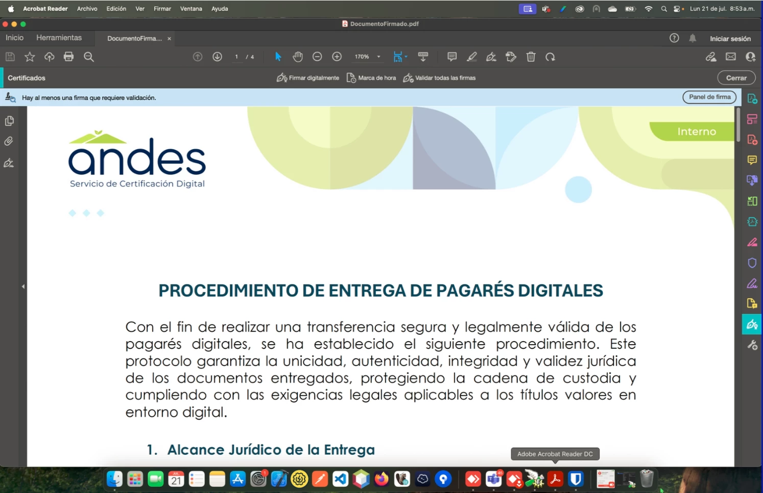

I need your support regarding an issue I'm experiencing when trying to sign a document using a digital signature certificate in Adobe Acrobat on a Mac device running the latest versions of macOS Sequoia.
When using a physical token, the cryptographic device does not allow the signature process to complete. Although I can draw the signature field, it seems that the system is not connecting to the Keychain, and therefore the certificate is not being retrieved or shown for selection. It just gets stuck at that point without any further action.

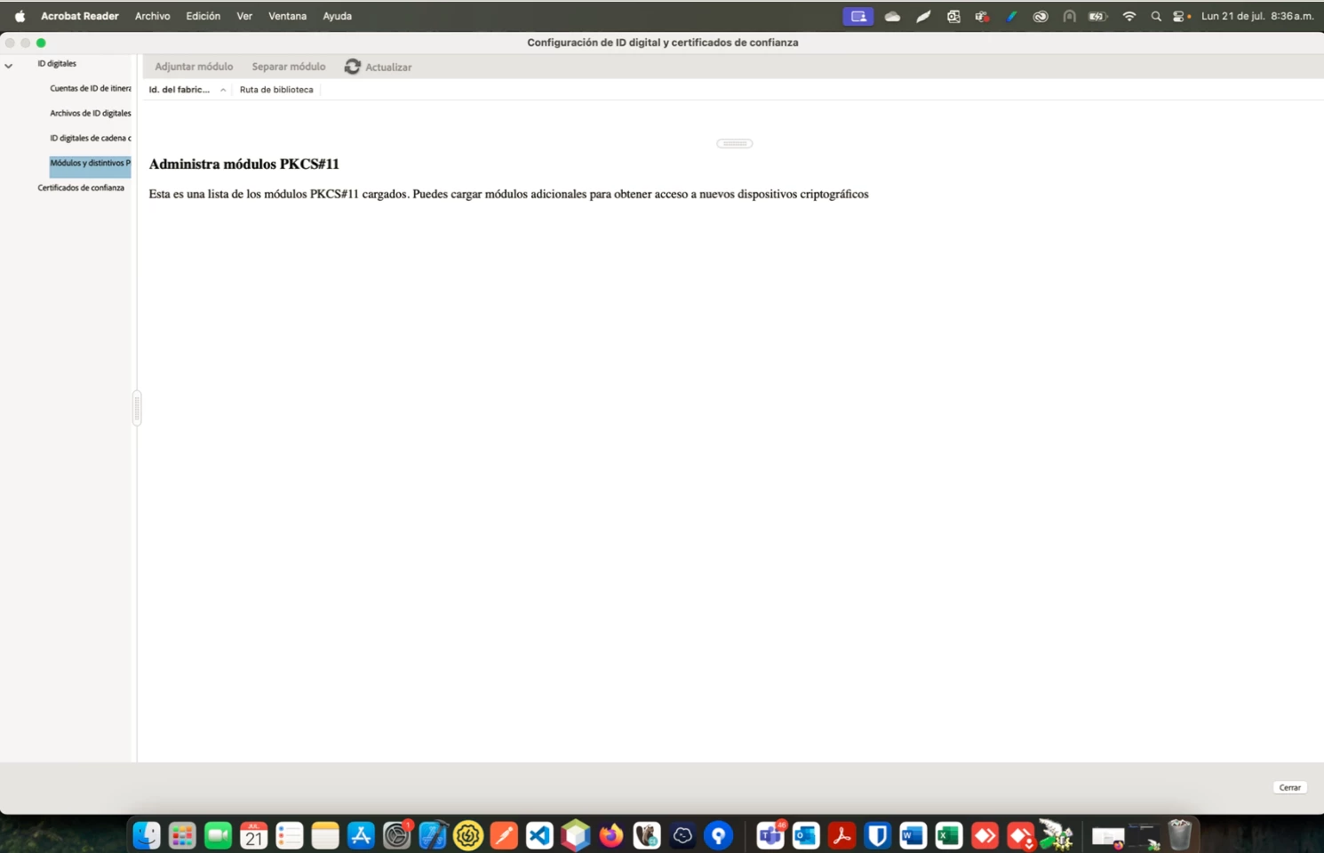

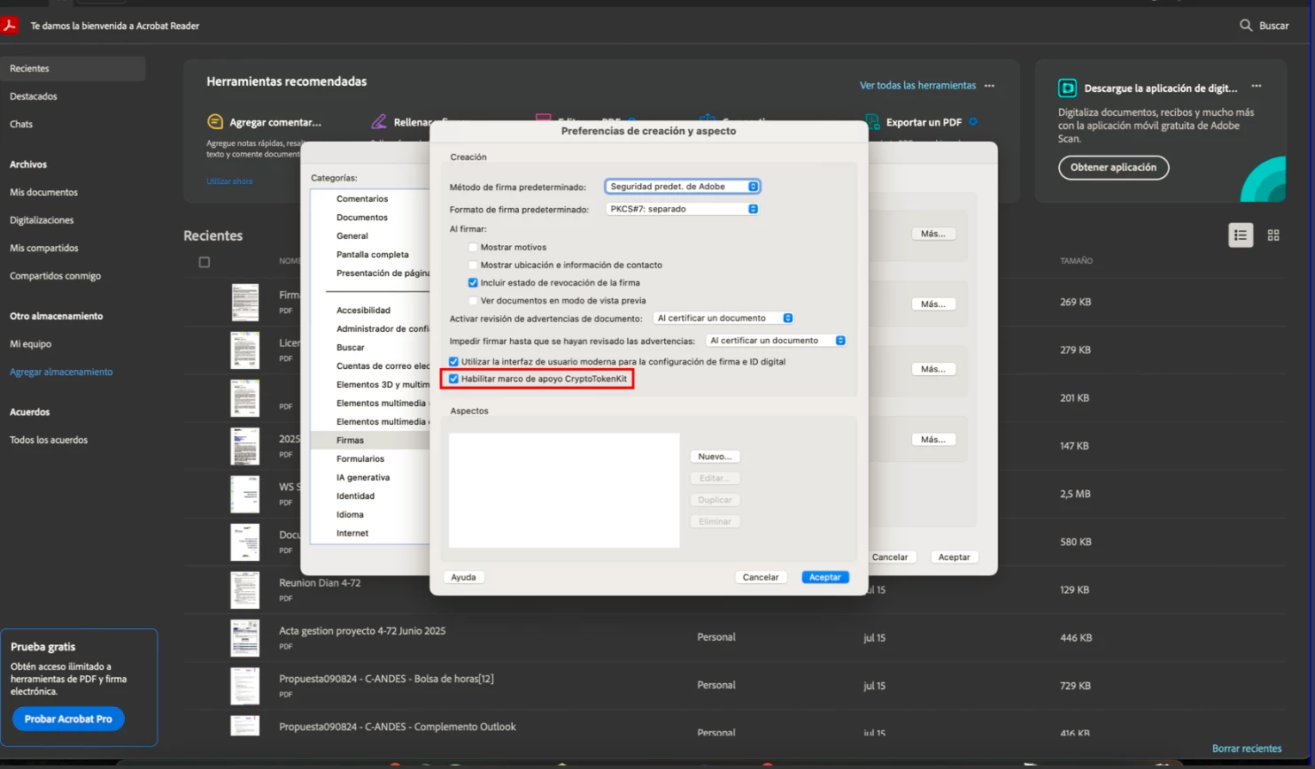

I confirm that we carried out the mentioned actions. Initially, we verified that the CryptoTokenKit option is already enabled by default, and the library is attached as shown in the image below.

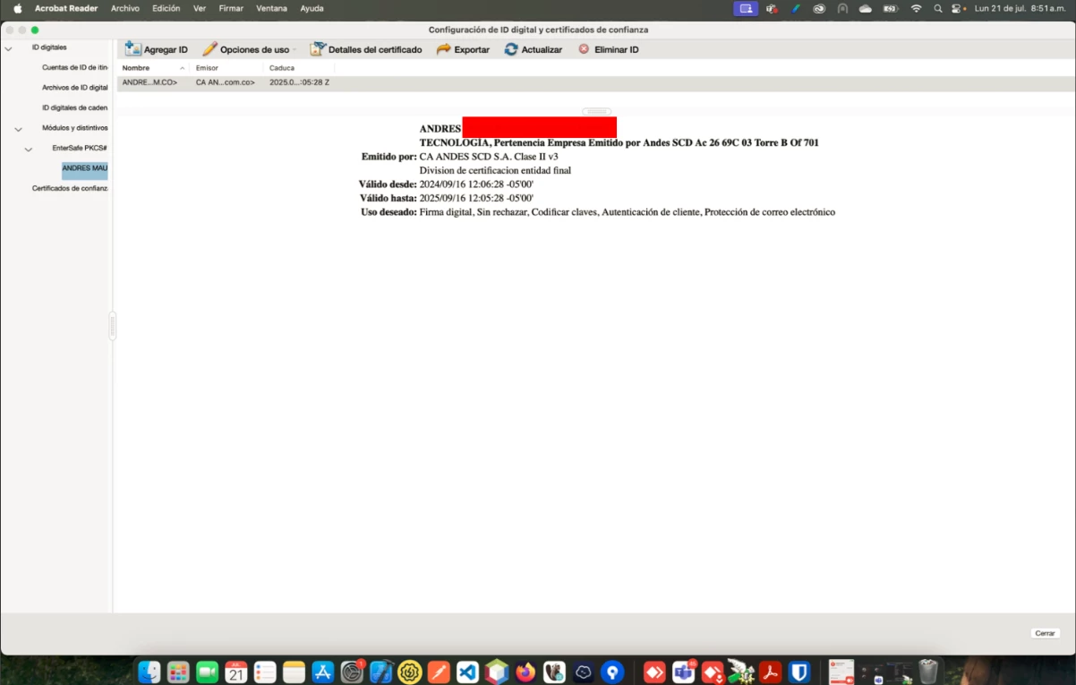

In addition to this, the library located at /usr/local/lib/libcastle.1.0.0.dylib was configured, and it was verified that the digital certificate is correctly recognized.
However, the issue persists and the system still does not allow the digital signature to be completed.
We would like to inform you that an error or incompatibility appears to be occurring with the 2025 versions of Adobe Acrobat, as it does not allow the PKCS#11 module/library to be attached.
