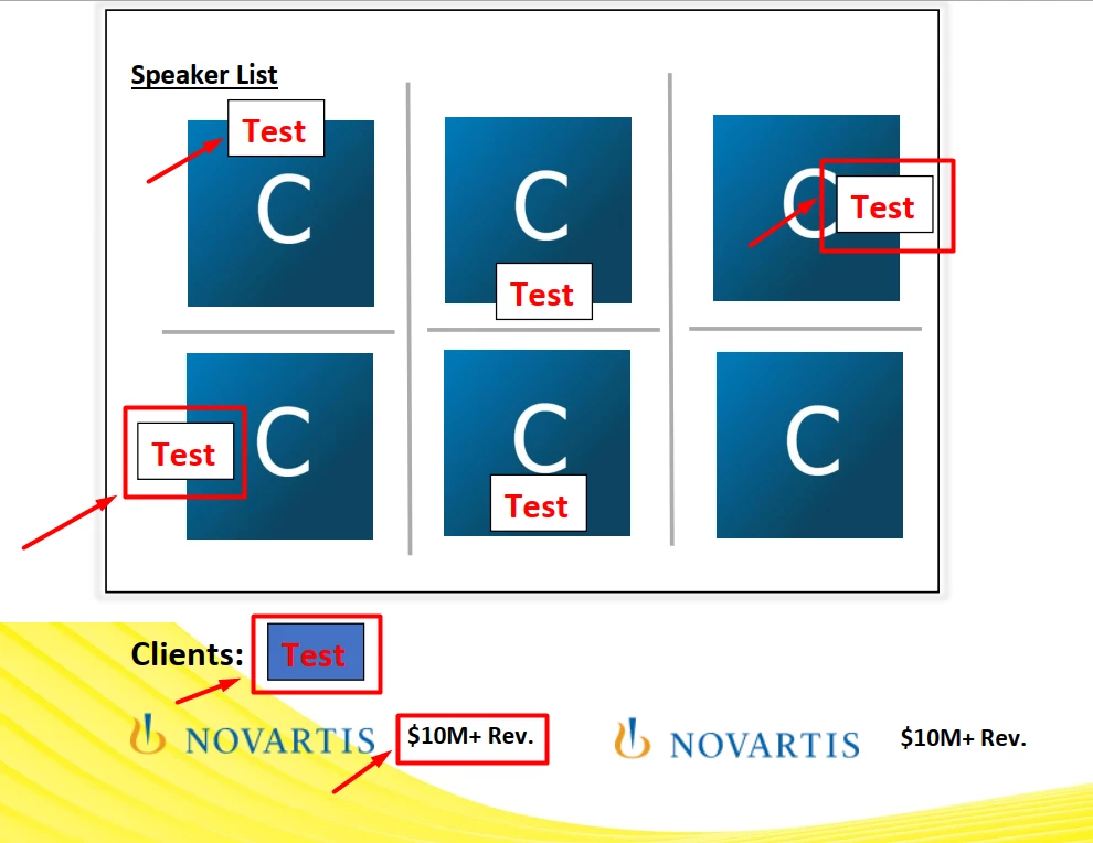

4. Text overlayed on an image (Test, $10M+ Rev) in this PDF (attached as PHT4) is extracted as a part of the image and not as text. The sections highlighted in the image are added as text. Anyway to extract them as text and not image?

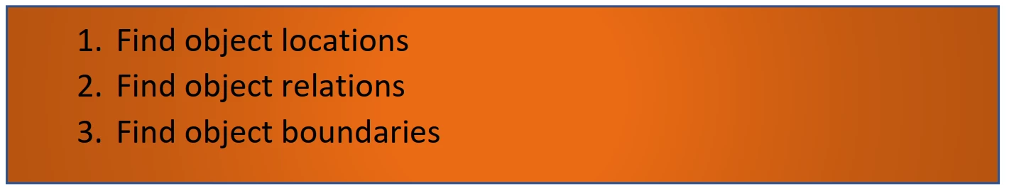

5. The below section in the PDF has a gradient background with a surrounding boundary. Can you help in locating this information in the json output?

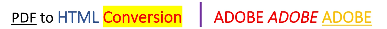

6. The line of text below has different formatting for different words. Had noted somewhere in the doc that formatting is only based on first character in a line. But, I am unable to find formatting info.
Here is the relevant section from the json:
"Bounds": [
72.02400207519531,
721.4035034179688,
271.4056091308594,
742.0164947509766
"ClipBounds": [
72.02400207519531,
721.4035034179688,
271.4056091308594,
742.0164947509766
"Font": {
"alt_family_name": "Calibri",
"embedded": true,
"encoding": "WinAnsiEncoding",
"family_name": "Calibri",
"font_type": "TrueType",
"italic": false,
"monospaced": false,
"name": "BCDGEE+Calibri-Light",
"subset": true,
"weight": 300
"HasClip": true,
"Lang": "en",
"Page": 0,
"Path": "//Document/Sect/P",
"Text": "PDF to HTML Conversion ",
"TextSize": 20.039993286132812,
"attributes": {
"LineHeight": 21.625,
"SpaceAfter": 11.375
