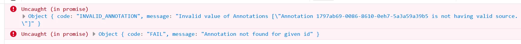

First Scenario:
1. We open a pdf(with acro fields) on the PDF Embed Viewer,
2. Add some annotations using the UI.
3. We saved the annotations on our database as a json format.
4. If we open again this document we load the annotations from the database using annotationManager api
5. Everything works fine.
Second Scenario:
1. We opened the same pdf on Scenario 1
2. Fill some data on some fields (or trigger some ui functions to update the pdf content)
3. Saved the pdf
4. Reopen the PDF
5. Annotations are not loaded , we are getting errors "Invalid value of Annotations" and "Annotation not found for given id".
Sumona GhoshCorrect answer
Adobe Employee
Feb 17, 2021 12:30 PM UTC
Quick Question:
If I created annotations on Document A and saved the annotations to the database, can I apply that annotations to Document B?
Document A and Document B may differ on the Acrofields Values.
Document A and Document B may also differ on some text contents but they will have the same Number of pages, Page Sizes/Dimensions.
Could you check the file ID of Document B (specified in the metadata field and passed to adobeDCView.previewFile)?
The error in the screenshot "Invalid value of Annotations ["Annotation <id> is not having valid source."]" is shown when the source mentioned in the annotation JSON does not match the file ID.
