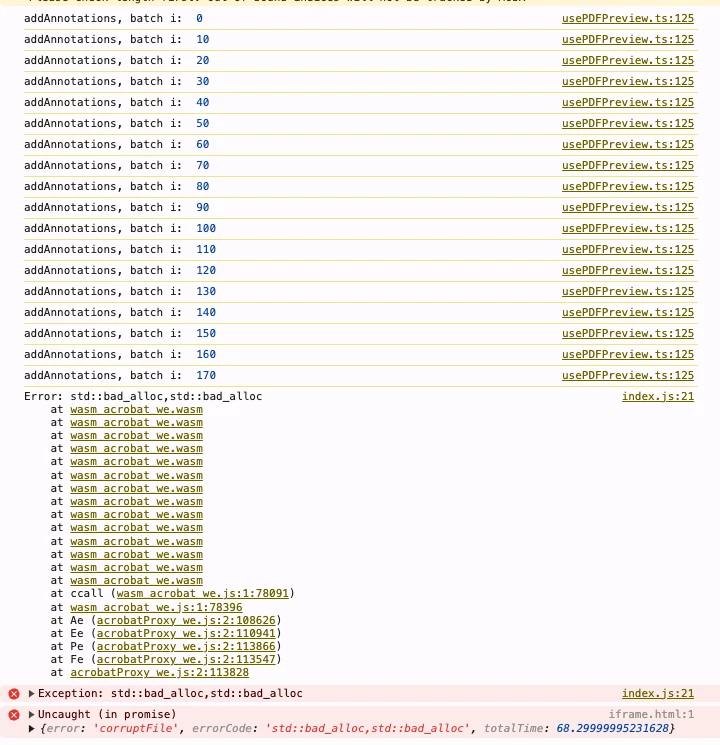

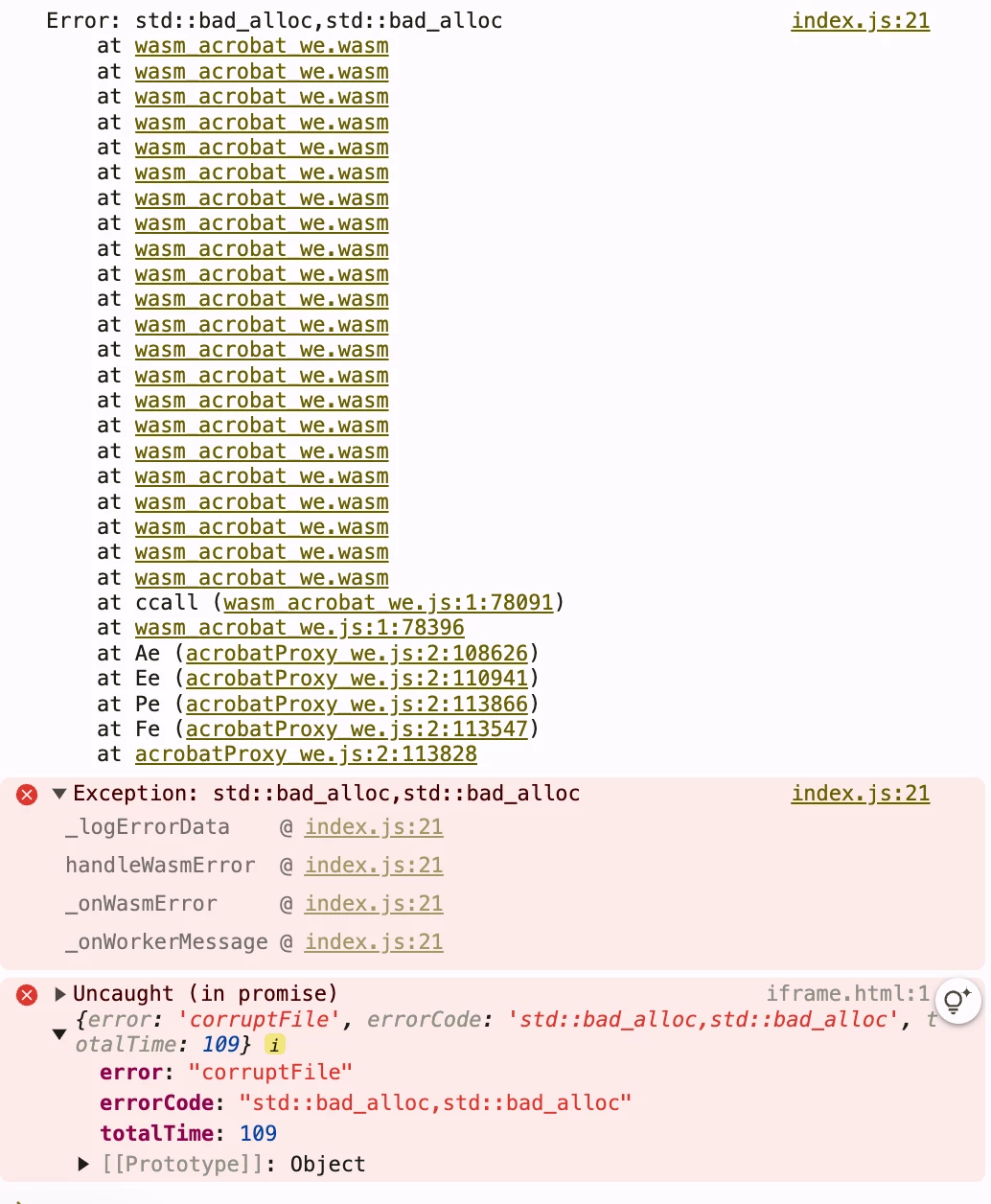

After loading the PDF viewer we call the annotation manager API's addAnnotations method. The promise eventually errors out with the following error (see image below) "Error: std::bad_alloc,std::bad_alloc", and we can see that some of the annotations have not been added.
Some important context is that we are attempted to add up to 500 different annotations to a given PDF. From my (admittedly basic) tests, the limit appears to be around 120 annotations before the error happens.
I have attached an image of the browser's console. This is in Google Chrome.

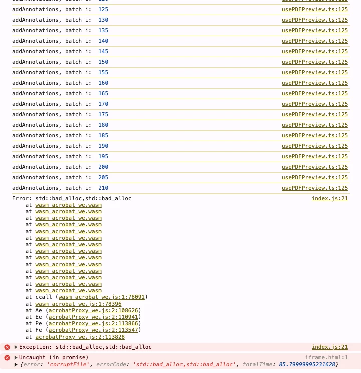

Hi Joel, thanks for your reply. Batches of 10 unfortunately ends up in the same result. I've attached my console log, after each promise resolved I printed the batch index. I also tried batches of 5, and despite getting a little further this time, still ends up failing.
Mar 6, 2025 5:29 PM UTC
Further to add, even running one at a time I am unable to get even to 200 annotations added. Strangely batches of 5 seems to get the furthest at around ~200 annotations.
