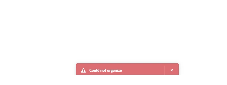

Error trying to Merge Documents "Could not organize"
I am trying to merge 14 small-ish pdf's together and I keep getting the same message. "Could not organize." I tried merging only 5 together, 4 together, etc and I still get the same message. It is so frustrating!! What does this message mean? How can I fix it?

I am having the same issue, i need to submit a document tonight and I am not able to merge the PDF's... this used to work before but now suddenly gives me "Could not Organize" error

Yes, i used jpeg files and converted them to PDF and im still getting the same error. None of these files are rights protected, they are invoices
