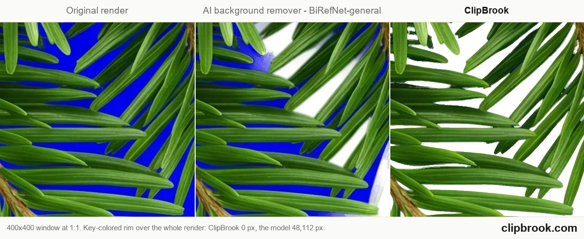

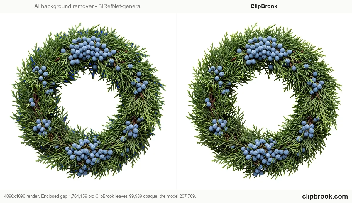

I tried the usual chain: the web tools, then rembg locally with u2net, then BiRefNet, then RMBG. They all failed the same way. A wreath is a ring, and inside the ring there's background that has to go — what I kept getting was a haze in there instead. Not opaque, not clear, a grey-blue smear that looked fine as a thumbnail and looked awful the moment a customer dropped it on a colored card. Pine needles came out as mush. Thin stems vanished, or came back with a colored rim baked in that no amount of levels would remove.
Then I looked at what those tools actually do, and it stopped being mysterious.

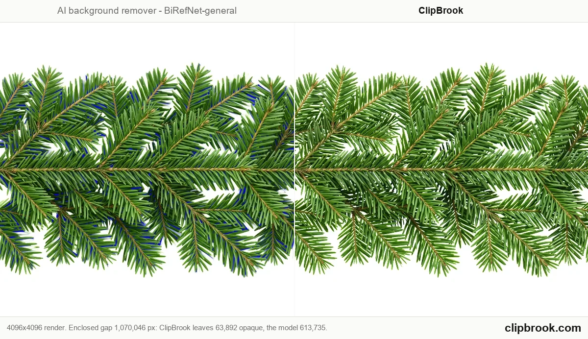

**rembg feeds BiRefNet a 1024×1024 copy of your image, gets a 1024×1024 mask back, and scales that mask up with LANCZOS to your original size.** On a 4096×4096 render that's a 4× upscale of a guess. u2net is worse: 320×320, then 12.8× up. A pine needle two pixels wide at 4K does not exist at 320×320. The information was thrown away before the network ever ran, so there is nothing to recover.
That explains all of it. The fog inside the ring is an upscaled mask blurring across a hole boundary. The rim is the mask sitting a few pixels off. The mush is 12.8×.

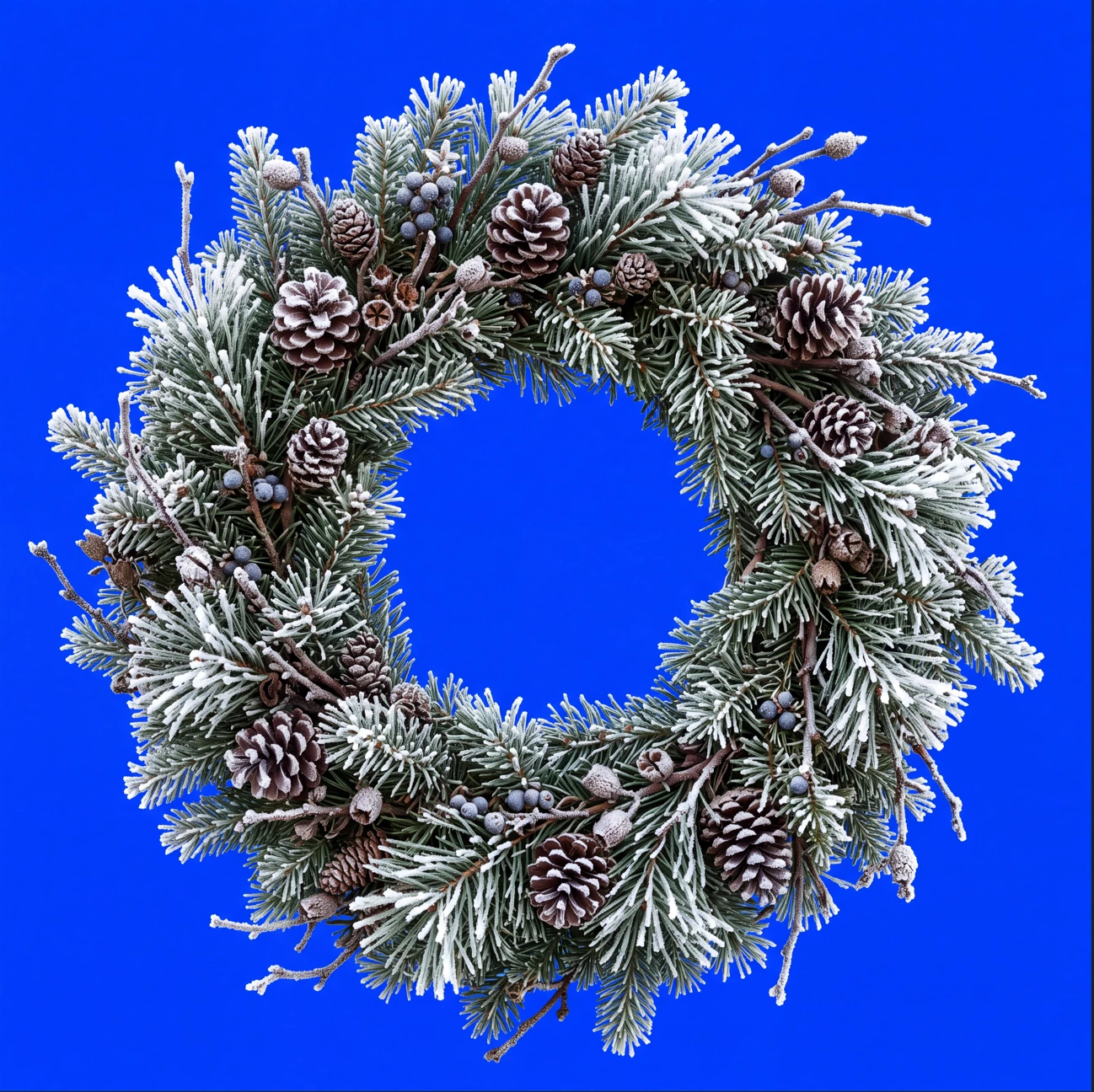

The idea: render the art on a flat, saturated color the subject does not contain, then remove that color by arithmetic. No network, no guessing.
Four things have to be true in the render, and generators break all four unless you ask:
1. **The background is one flat color, edge to edge** — no gradient, no vignette, no darkening in the corners.
2. **That color stays at full brightness inside every gap** — the holes between leaves are the hard part. Generators love to shade them.
3. **No soft edges** — no depth-of-field blur, no glow, no halo. A feathered edge is unrecoverable.
4. **No colored light bouncing onto the subject.** Cast shadows and ambient occlusion tint your subject with the background color.

Now the background is one known color and the cut is arithmetic instead of a guess. Here's what happens to that render, at full resolution, every pixel:
**Measure the actual key color.** Not `#0000FF`, what the generator really produced. "Pure blue" from a diffusion model usually carries a green channel somewhere in the 25–70 range. Guessing the key instead of measuring it is where a lot of naive chroma-key code falls over.
**Sort every pixel into subject, background, or transition** by how far its color sits from that measured key.
**Solve real partial alpha in the transition band.** A needle edge is genuinely half-subject, and it gets a genuine intermediate alpha rather than a hard yes/no.

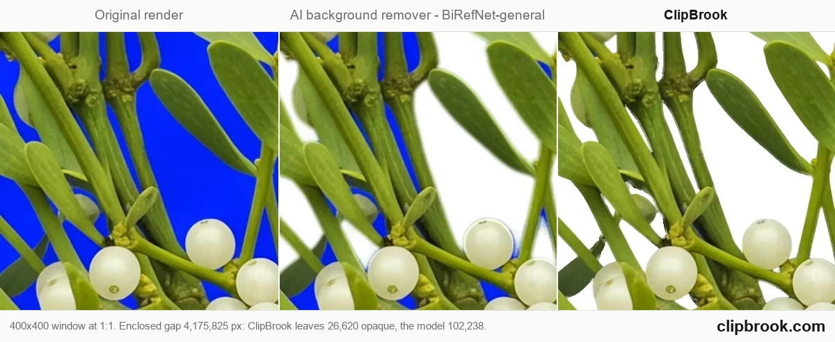

**Find enclosed pockets.** Any background-colored region that never touches the image border is the inside of a wreath, and it gets cleared too. This is the one a matting network structurally cannot do it has no information about a hole it can't see the outside of.

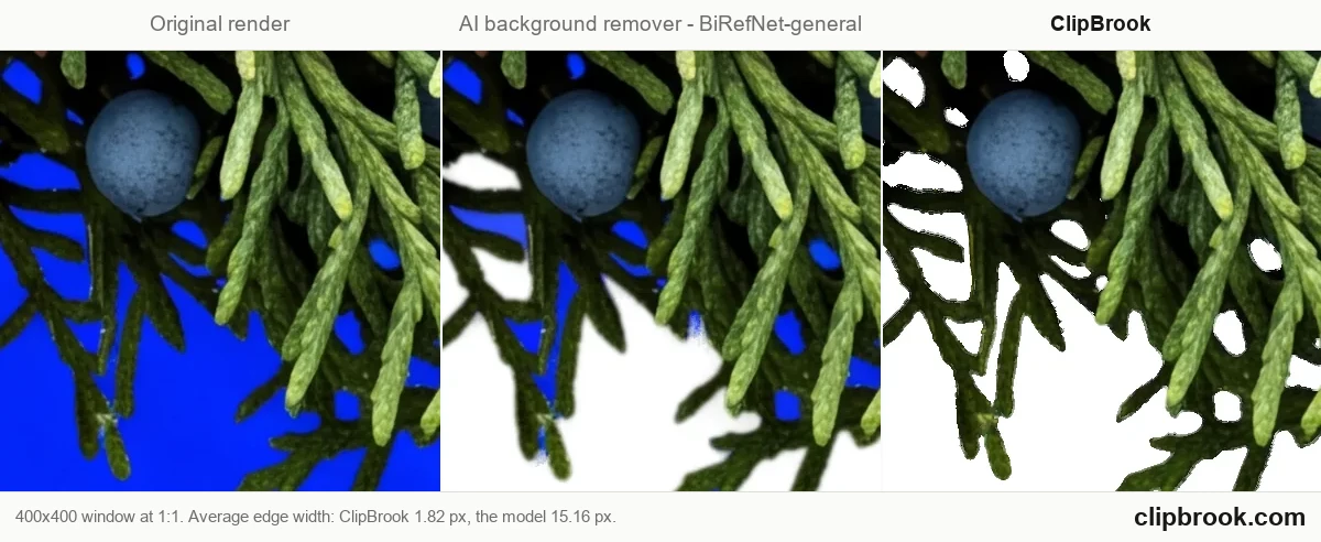

**De-spill.** Edge pixels pick up the key color from the background. The fix samples the subject's own interior color at several erosion depths and pulls the tint back out. That multi-scale part matters more than I expected, a single depth left a cyan rim on fir needles for weeks before I understood why.
