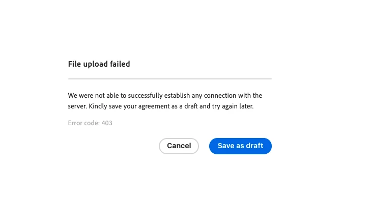

Adobe Sign: File Upload Failed/Not able to Establish Connection
I'm trying to use the Adobe Sign feature in Adobe Acrobat Pro.  I go to send the file, press the "review & send" button, then to the send screen where I press send, and get the following error message.
File upload failed
_____
We were not able to successfully establish any connection with the server.  Kindly save your agreement as a draft and try again later.
Error Code: 403
Error messag also attached.
Any help is appreciated.

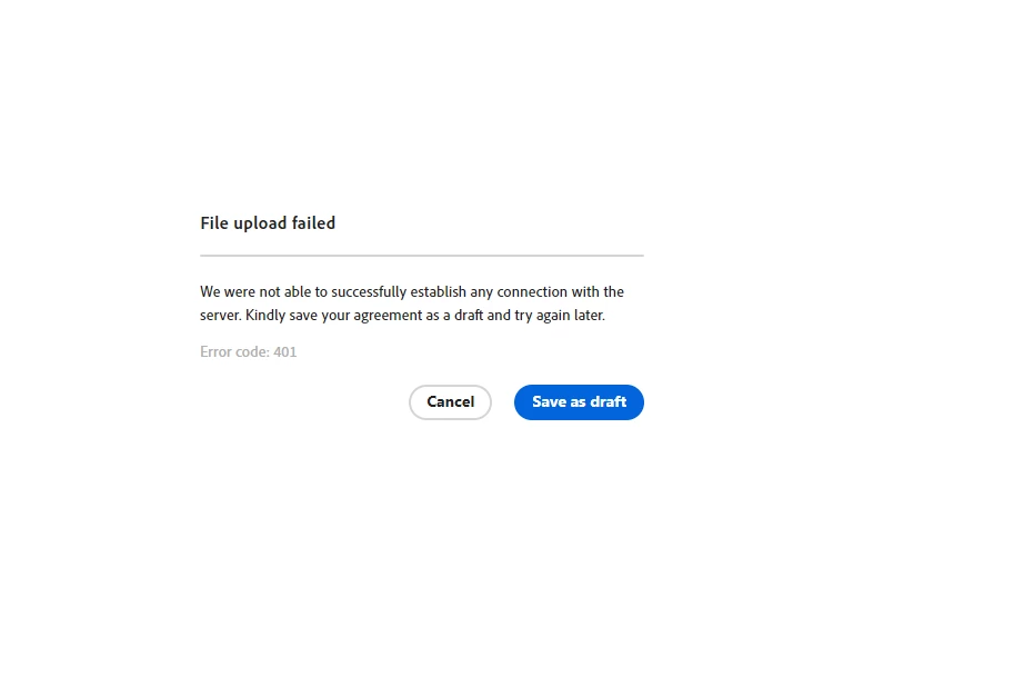

We're getting the error, except our's is "Error Code: 401"
We're using Acrobat Pro 2023.008.20470
We've tested logging off and on; no help
We're checking if our firewall is somehow blocking the connection; we're also going to test from a home loction
