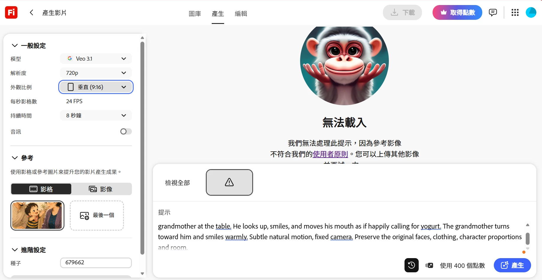

遺憾的是,有些影像產生引擎不允許產生兒童影像。不妨試試其他引擎,例如 GPT?

Hey ​@陳軒甫
Common Issues
Anything to do with Children
  • if it has children or child like images (an absolute no/ firefly will not generate anything that even resembles a child/ even childlike)
or
  • - the prompt has words associated with children example: boy, girl, kid, kids, child, children and so on...
    Many Generation Models will not generate anything to do with children.
Cheers

我把我和兒子吃優格的圖片上傳  結果被拒絕了  無法理解

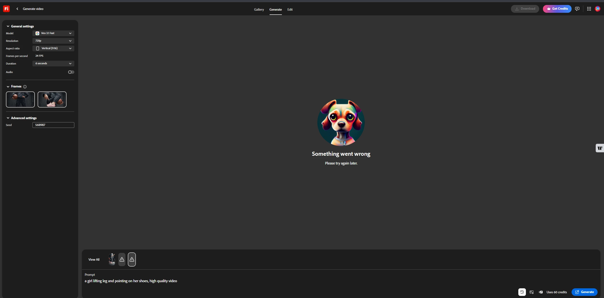

cant generate ai videos in firefly, always something went wrong

Apr 8, 2026 9:36 AM UTC
Hi SERGEI_ANDREICHUK0901
Thanks for bringing this to us.
The reason you couldn’t generate using the settings you shared is that Firefly does not allow video generation that includes children or minors in most models including Veo 3.1 fast.
You can change the model to Runway Gen-4.5 or Kling 2.5 Turbo which allow children in keyframes.
Let us know if you have any other questions.
Hajar

Veo 3.1 Error encountered while creating video
For about a week now, when I try to create a video with Veo 3.1, I keep getting an error message saying "An error occurred, please try again."

Mar 23, 2026 2:29 PM UTC
Hi Temel O,
Thank you for reaching out,
The reason you couldn’t generate using the settings you shared is that Firefly does not allow video generation that includes children or minors in most models including Veo 3.1.
Hajar
